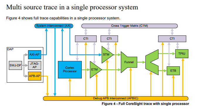

CoreSight Technical
The i.MX RT series MCU is based on the Cortex-M core and the CoreSight Technical is a new debugging architecture launched by ARM in 2004 and is also a part of the core authorization, supports the debug and trace feature for Cortex-M core-based MCU.
CoreSight is very powerful. It contains many debugging components (ie various protocols). The following figure is from the CoreSight Technical Introduction Manual, which shows the connections between various debugging components under the CoreSight architecture.
Fig 1 CoreSight Technical
This article does not mainly aim to introduce CoreSight technical. Therefore, for CoreSight, we only need to know that it in charge of the main debugging work and the CoreSight can access the system memory and peripheral register from the AMBA bus through the DAP component in real-time, definitely, it includes the code in the external serial Flash.

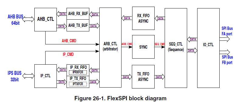

Figure 2 is the FlexSPI module block diagram.
On the right side of the block diagram is the signal connection between FlexSPI and external serial Flash. The left side is the connection between FlexSPI and the internal bus of the i.MXRT system. There are two types of bus interface: 32bit IPS BUS (manual manipulate the FlexSPI register sends Flash reading and writing commands) and 64bit AHB BUS (FlexSPI translates the AHB access address and automatically sends the corresponding Flash reading and writing commands) which is the key feature enables the XIP available.
Fig 2 FlexSPI module
In the Reference manual, it lists detailed information about the AHB bus:
- AHB RX Buffer implemented to reduce read latency. Total AHB RX Buffer size: 128 * 64 Bits
- 16 AHB masters supported with priority for reading access
- 4 flexible and configurable buffers in AHB RX Buffer
- AHB TX Buffer implemented to buffer all write data from one AHB burst. AHB TX Buffer size: 8 * 64 Bits
- All AHB masters share this AHB TX Buffer. No AHB master number limitation for Write Access.
In addition, the AHB bus includes the below-enhanced features to optimize the reading of Serial Flash memory.

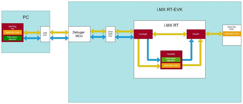

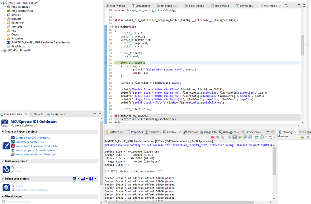

Debugging process of serial Flash
Fig 3 illustrates the debugging process of serial Flash with the RT series MCU and in basic, the overview of the debugging process is not complicated.
When you click IDE debugging icon, the Flash driver algorithm (executable file) pre-installed in the IDE will be downloaded to the internal FlexRAM of i.MXRT via the debugger firstly. The Flash driver algorithm provides FlexSPI initialization, erase and programming APIs, etc.
Next, the debugger caches the application code (binary machine code) in FlexRAM in segments prior to calling the Flash programming API to implement the program work.
After completing programming application code (from FlexRAM to Flash), CoreSight will take over the debugging work.
At this time, the CPU can access the serial Flash that connects the FlexSPI module through the AHB bus, in another word, CoreSight can control and track code in real-time, and single-step debugging is available too in the IDE.
Fig 3

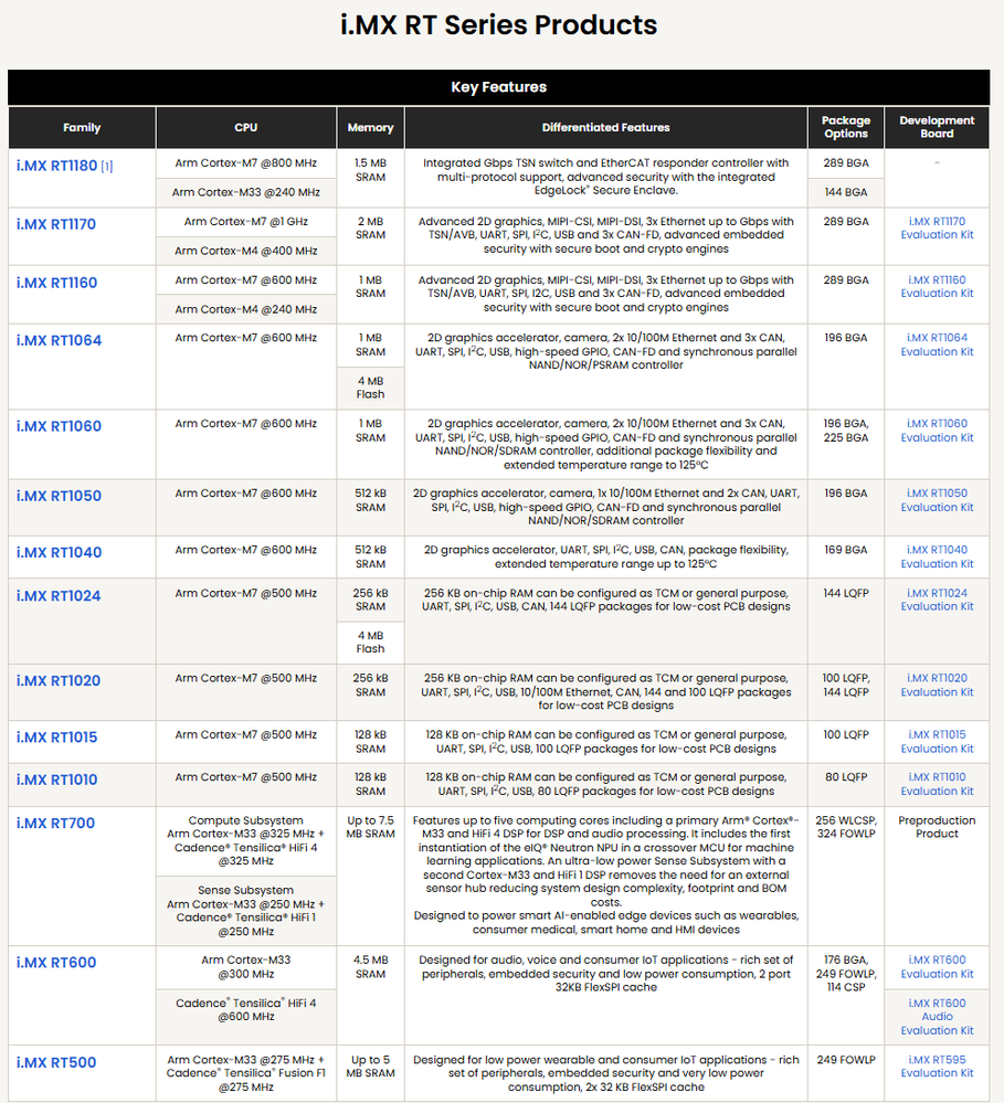

The latest version (24.12) of MCUXpresso IDE supports all i.Mx RT series MCU (as the following figure shows).
Fig 4 MCUXpresso IDE supported Parts

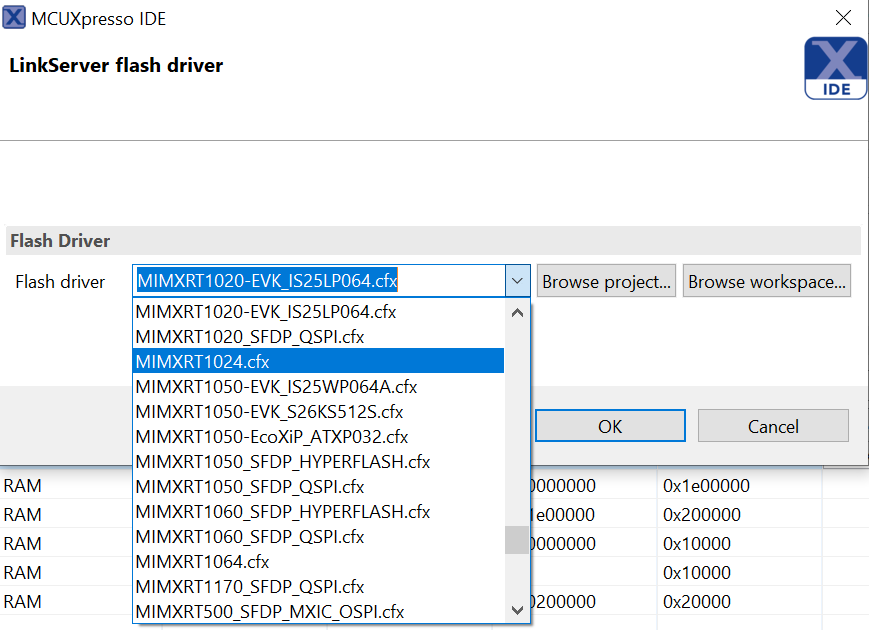

The  developer should select a suitable flash driver file to apply to his board (Fig 5).
Fig 5 Flash driver files

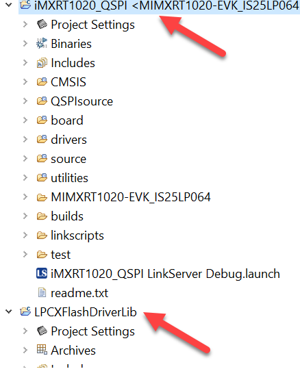

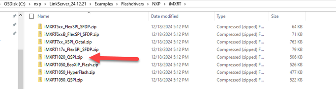

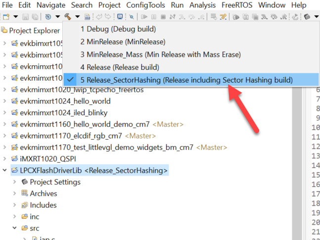

a) Select a source project

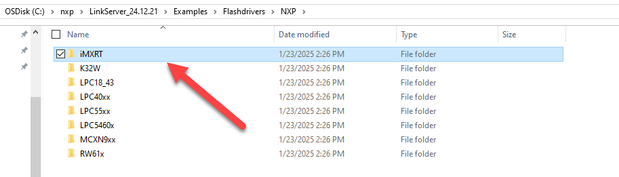

Flashdriver projects  on latest versions of the MCUXpresso IDE are delivered in Linkserver package. You can install Linkersever independently or during the MCUXPresso IDE installation. Therefore If you already installed MCUXpresso IDE you do not need to manually install the Linkserver, unless you want the latest version of Linkserver.
If you are using MCUXpresso IDEv24 or above flashdriver projects can be found at  C:\nxp\LinkServer_24.12.21\Examples\Flashdrivers\NXP subdirectory within the MCUXpresso's Linkserver installation directory (as Fig 7 shows) and iMXRT folder contains some flash driver projects for external flash parts that work with the RT series MCU (as Fig 8 shows).
Fig 7
Fig 8
Select the flash driver project which is the closest to the target as a prototype, in this case, we select the iMXRT1020_QSPI project, extract the project file and import them in the MCUXpresso IDE (as Fig 9).
Fig 9

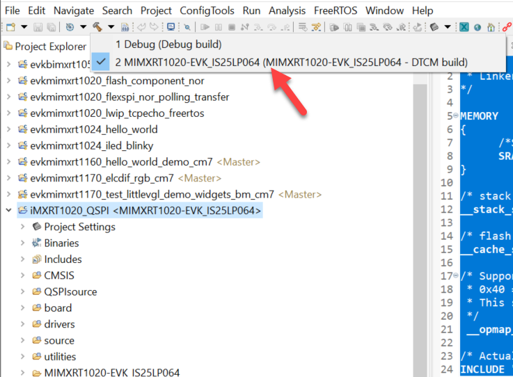

So it needs to adjust the pin initialization in the BOARD_InitPins() function in pin_mux.c.

d) Recompile
In the LPCXFlashDriverLib project, select the Release_SectorHashing option prior to clicking the Build icon to generate libLPCXFlashDriverLib.a file (as Fig 10 shows).
Fig 10
Next, in the iMXRT1020_QSPI project, select the MIMXRT1020-EVK_IS25LP064 option (as Fig 11 shows), then click the Build icon to generate a new flash driver file that resides in ~\Examples\Flashdrivers\NXP\iMXRT\iMXRT1020_QSPI\iMXRT1020_QSPI\builds directory.
Fig 11
Note: I've attached a test project which is based on the hello_world demo that comes from the RT1024's SDK library, in addition, the attachment also contains the new flash driver and corresponding debug script files, so please give it a try.
Debug the  flash driver of MCUXpresso IDE
As mentioned on other parts of this document you could change the pin mux assignments and edit the flashdriver. However, before testing your custom flash driver you could do a simple debug. All the flashdriver projects come with a debug build configuration.
Make sure debug build configuration is enabled as shown in Fig 12
Fig 12
 After enabling debug build you can simply trigger a standard debug operation, and the IDE will load into SRAM a simple test code. The test code will detect the flash and perform an erase procedure. See Fig 13
Fig 13
In the terminal you will see the output log from the test program.
