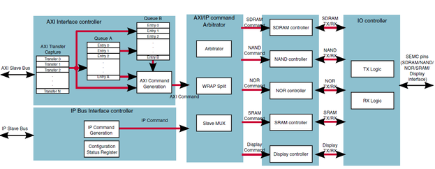

The SEMC is a multi-standard memory controller optimized for both high performance and low pin count. It can support multiple external memories in the same application with shared address and data pins. The interface supported includes SDRAM, NOR Flash, SRAM, and NAND Flash, as well as the 8080 display interface.

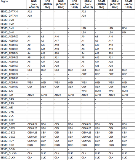

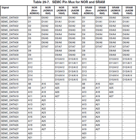

It is important to mention that RT1170 supports ASYNC and SYNC mode on the SRAM however SYNC mode is not supported in all RT devices, e.g. RT1050 does not support SRAM SYNC mode. It is important to consider the pin mux for these devices, for this you can refer to table 29-7 for the RT1170.
Please consider that pins controlled through the IOCR register should be static. This means that if you configure, for example, SEMC_ADDR08 to be CE on the SRAM it cannot be used in the same application as A8 in an SDRAM.

  1. Configure the IOCR register to choose CS pins. For this, you can refer to table 29-6. I suggest using CSX pins for CS signals of the SRAM. The Init function from the SDK sets this register incorrectly so write this register outside the function
SEMC->IOCR |= 0x00908BB6;	// A8:CE#0, CSX0:A24, CSX1:A25, CSX2:CE#1, RDY:CE#2
