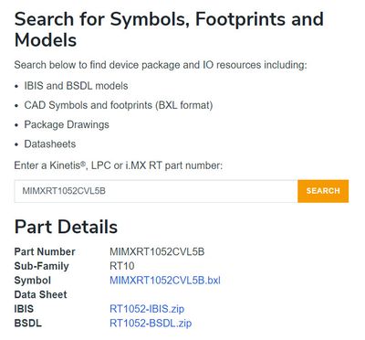

Obtaining the footprint for Kinetis/LPC/i.MXRT part numbers is very straightforward using the Microcontroller Symbols, Footprints and Models Library homepage, on the following link:
https://www.nxp.com/design/software/models/microcontroller-symbols-footprints-and-models:MCUCAD?tid=...

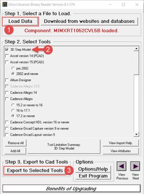

First, obtain the BXL file for the part number you are interested in. In this example the MIMXRT1052CVL5B.blx.
Then, open the Ultra Librarian project and load this file using the “Load Data” button, and select the “3D Step Model” checkbox from the Select Tools options. Finally, select the Export to Select Tools option.
Once the exporting process is finished, the step file will be available on the path UltraLibrarian/Library/Exported.

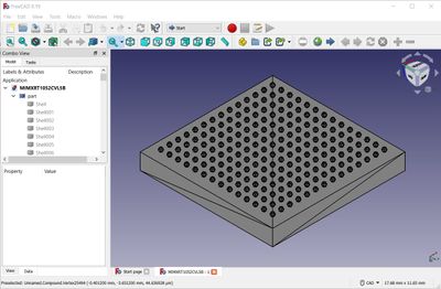

The STEP (.stp) file can be opened in CAD suites that support solid 3D objects, like FreeCAD which is open source.
