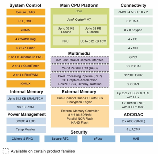

        It has a rich peripheral which makes it suit for a variety of applications, in this demo, the PXP (Pixel Pipeline), CSI (CMOS Sensor Interface), eLCDIF (Enhanced LCD Interface) allows me to build up camera display system easily
Fig 1 i.MX RT series
Fig 2 i.MX RT1050 Block Diagram

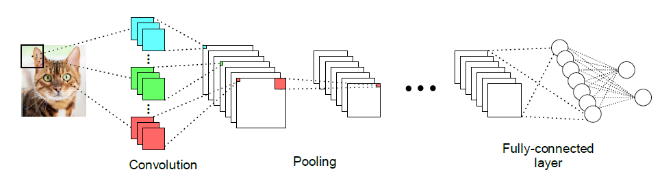

       Convolutional Neural Networks (CNNs) is one of the main ways to do image recognition and image classification. CNNs use a variation of multilayer perception that requires minimal pre-processing, based on their shared-weights architecture and translation invariance characteristics.
Fig 4 Structure of a typical deep neural network
        Above is an example that shows the original image input on the left-hand side and how it progresses through each layer to calculate the probability on the right-hand side.

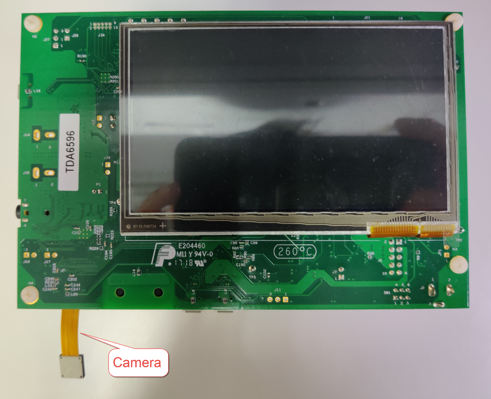

Hardware
  • MIMXRT1050 EVK Board;
  • RK043FN02H-CT(LCD Panel)
Fig 5 MIMXRT1050 EVK board

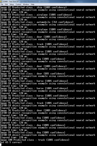

Fig 6 illustrates the steps of deploying the neuro network mode on the embedded platform. In the cmsis_nn_cifar10 demo project, it has provided the quantized parameters for the 3 convolution layer, so in this implementation, I use these parameters directly, BTW, I choose 100 images randomly from the Test set as a round of input to evaluate the accuracy of this model. And through several rounds of testing, I get the model's accuracy is about 65% as the below figure shows.

Fig 7 cmsis_nn_cifar10 demo project test result
The CIFAR-10 dataset is a collection of images that are commonly used to train ML and computer vision algorithms, it consists of 60000 32x32 color images in 10 classes, with 6000 images per class ("airplane", "automobile", "bird", "cat", "deer", "dog", "frog", "horse", "ship", "truck"). There are 50000 training images and 10000 test images.

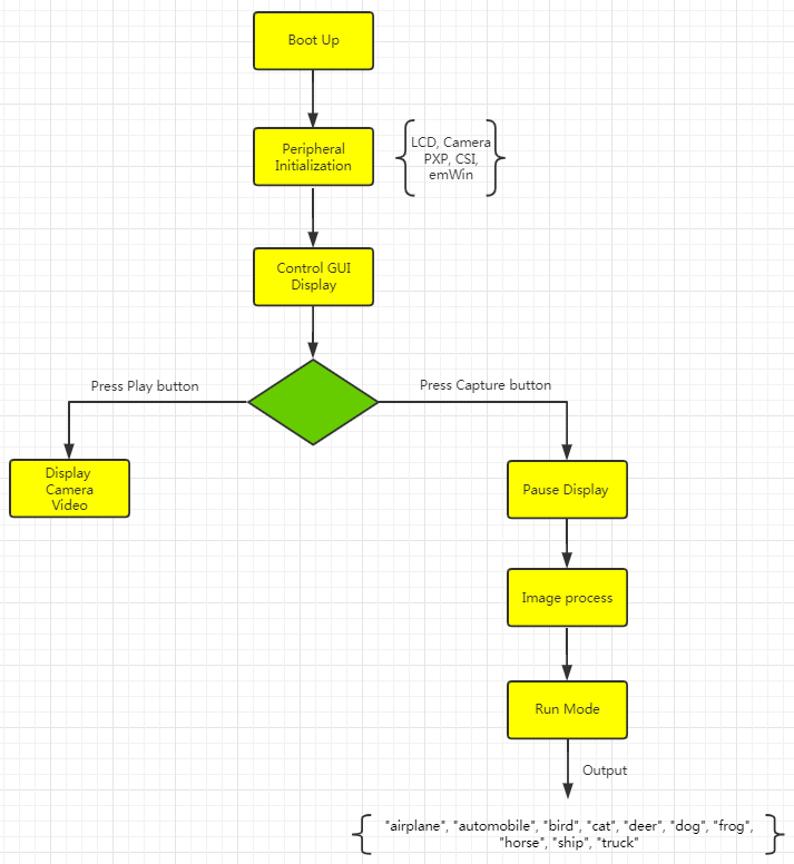

        After POR, various components are initialized, like system clock, pin mux, camera, CSI, PXP, LCD and emWin, etc. Then control GUI will show up in the LCD, press the Play button will display the camera video in the LCD, once an object into the camera's window, you can press the Capture button to pause the display and run the model to identify the object. Fig8 presents the software structure of this demo.
Fig 8 Embedded platform software structure

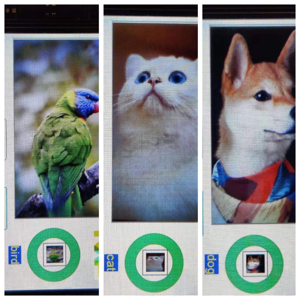

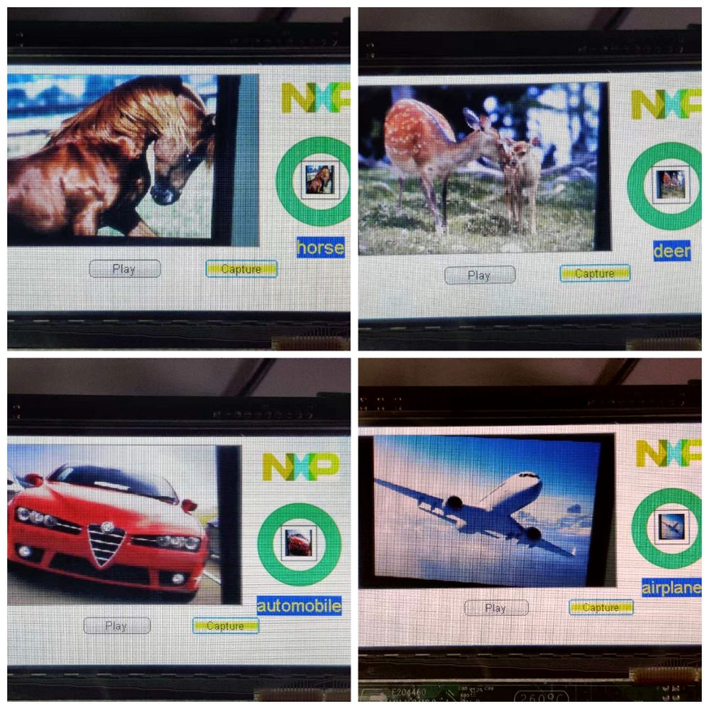

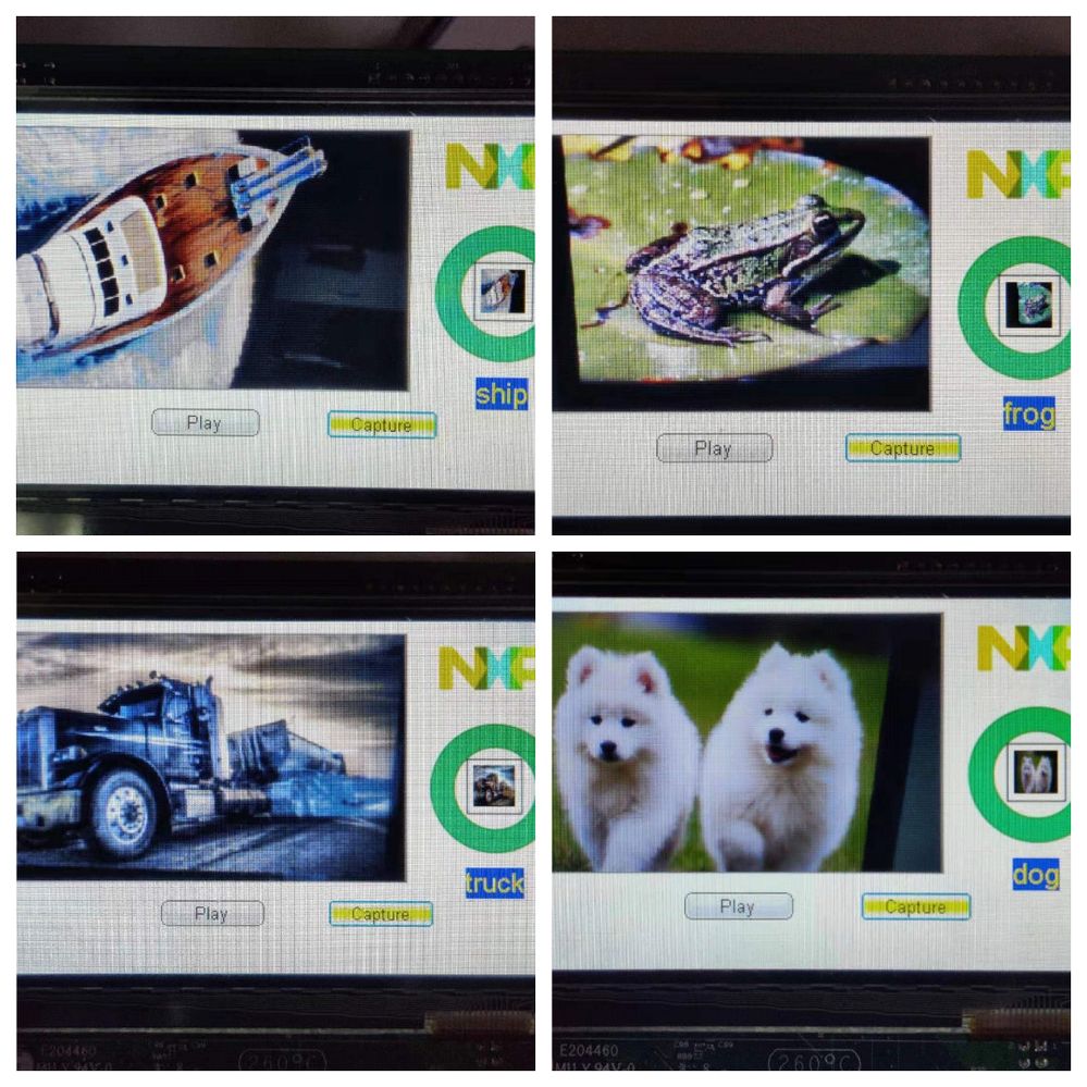

Object identify Test
The three figures present the testing result.
Fig 9
Fig 10
Fig 11
