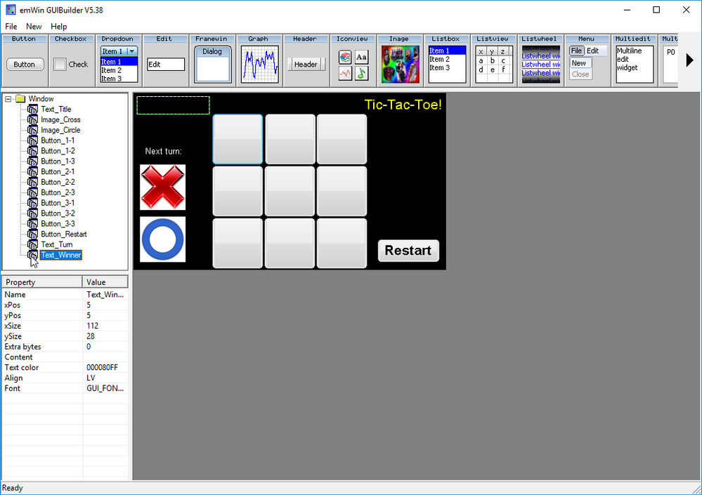

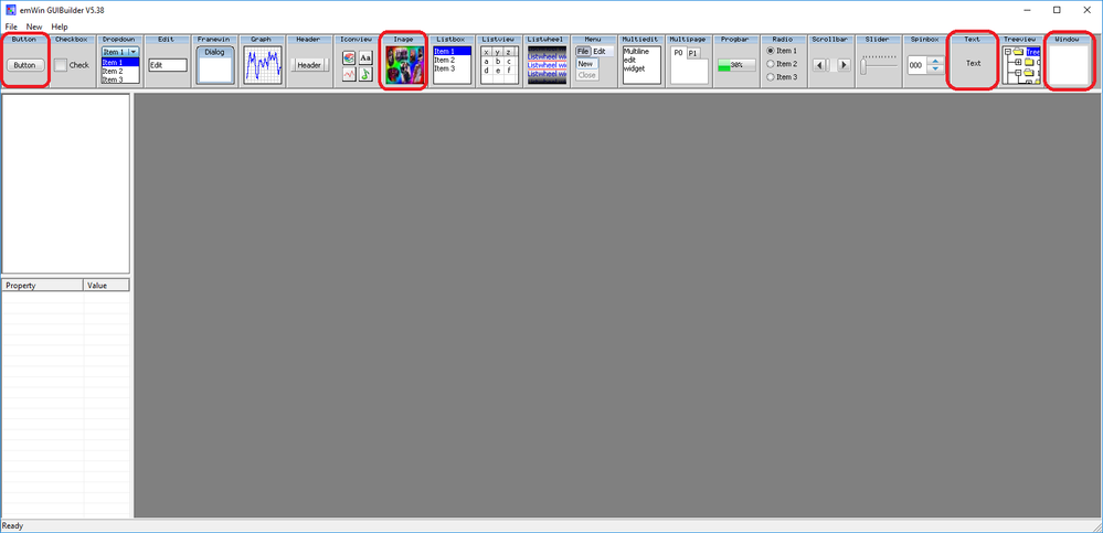

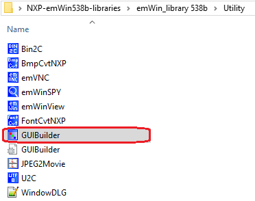

For this demo, just GUIBuilder utility is used, and from this utility, just four widget elements are implemented on the application: Window, Text, Button and Image.
At the beginning, one Window is added, configuring its xSize and ySize to 480 x 272, matching with screen's resolution.
Over this Window, all the other elements are placed. Each Widget have proprieties that could be added/modified with the right click menu.
The overall number of used widgets elements are the following:
  • Three Text widgets, one for the title, other to indicate the next turn, and a third that is empty, because it will be dynamically updated to indicate the winner of the game (or indicating a Draw).
  • Two Image widgets, on where BPM files are loaded and converted to constant arrays, to have the Cross/Circle icons indicating the current turn of the game.
  • Ten Button widgets, one to reinitialize the game, and the other nine to build the 3x3 array used for the game.
The complete application layout is shown on the following figure:
Then, click on "File->Save" menu, and a file named "WindowDLG.c" file should be created on the same folder on where GUIBuilder utility is located. The "WindowDLG.c" file of this demo, as well as the BMP files for the cross/circle icons could be found on the attachments of this document. Additionally, you could also click on "File->Open" to open the downloaded "WindowDLG.c" file and modify it by your own.

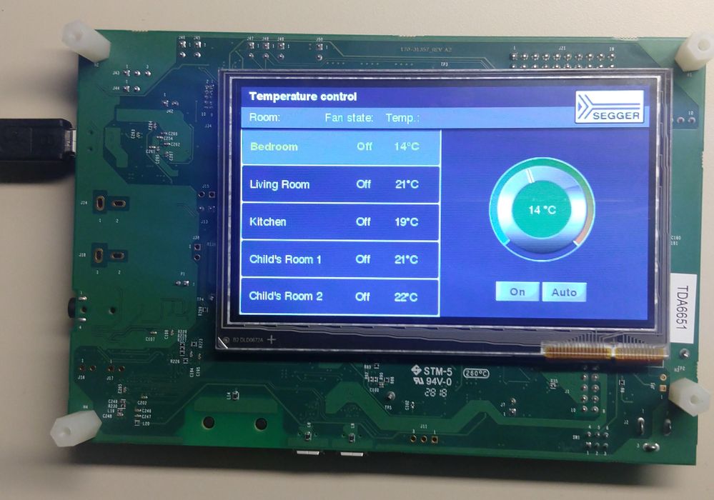

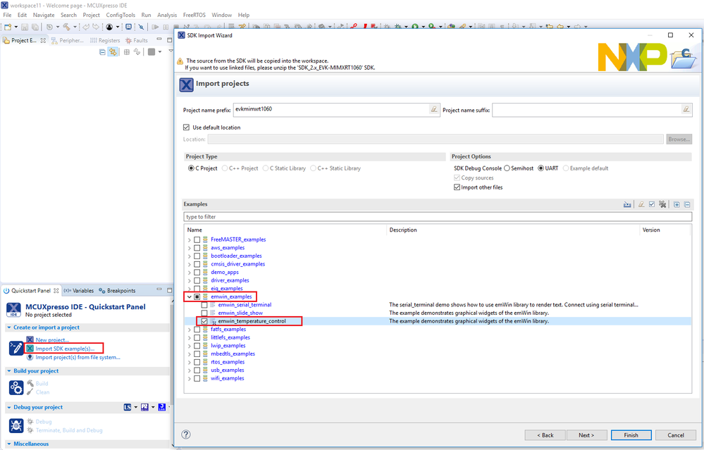

1) First of all, it is required to import the "emwin_temperature_control" demo included on MCUXpresso SDK for MIMXRT1060-EVK board:
Import SDK example(s) -> evkmimxrt1060 -> emwin_examples -> emwin_temperature_control
2) Just after importing the demo, by convenience we have renamed the project and the "source->emwin_temperature_control.c" to "evkmimxrt1060_emwin_tictactoe" and "emwin_tictactoe.c" (right click -> rename).
After applying these changes, the demo should be able to be compiled and downloaded without errors and running without issues:

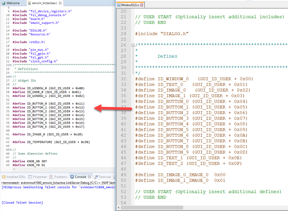

3) Then, open the "WindowDLG.c" file generated by the GUIBuilder and locate the "Defines" section. Copy all of them and replace the Definitions for Widgets IDs already included on the "emwin_tictactoe.c" file.

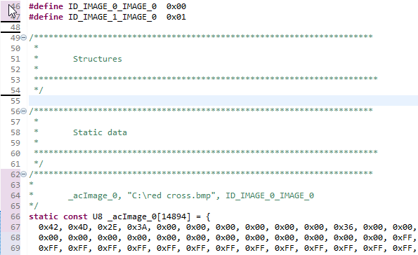

5) Add the "_acImage_0" and "_acImage_1" arrays from the "WindowDLG.c" file to the "Static data" section of "emwin_tictactoe.c" file.

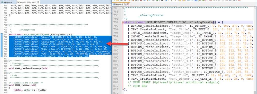

6) Replace all the elements from the "_aDialogCreate" array from the "emwin_tictactoe.c" with the ones from the "WindowDLG.c" file.

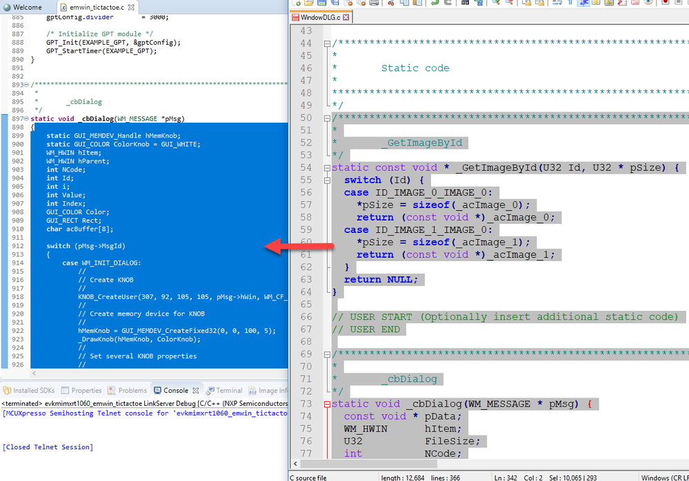

7) Add the function "_GetImageById" and replace the function "_cbDialog" from the "WindowDLG.c" file to the "emwin_tictactoe.c" file.

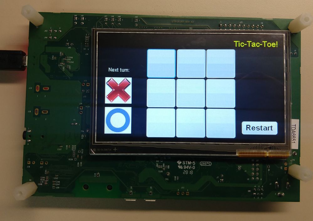

8) Until here, the application should be compiled and downloaded without issues, although there is not included any functionality to perform the match. The downloaded layout is shown on the following image:

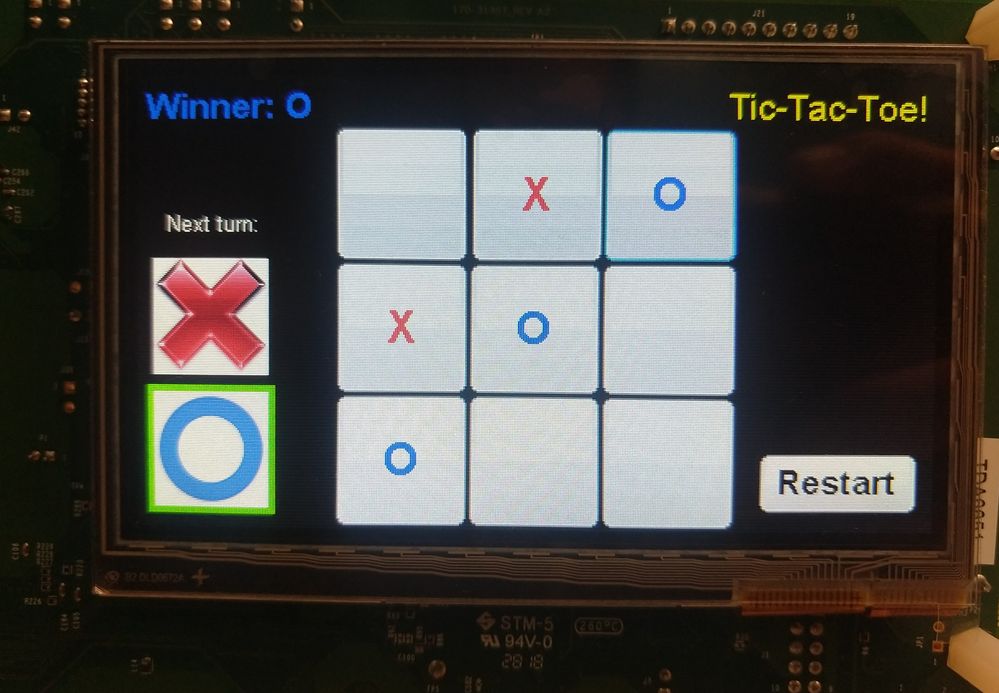

5. FUNCTIONAL DEMONSTRATION
Below are shown captures of the application running, when Cross wins, when Circle wins, and when the match is a draw.
