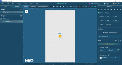

Once the Lottie widget has been added to the GUI on GUI Guider, you will want to follow the common steps to import this GUI into the MCUXPresso project.

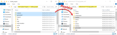

  1. Replace the "custom" and "generated" folders on the MCUXpresso project with the GUI Guider folders:
    1. <GUI Guider Project Installation>\custom.
    2. <GUI Guider Project Installation>\generated.

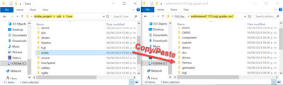

  1. Copy the "lib" folder from: <GUI Guider Project Installation>\lib into the MCUXpresso project.
  1. Copy the "rlottie" folder from: <GUI Guider Project Installation>\sdk\core\rlottie into the MCUXpresso project.

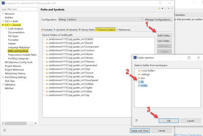

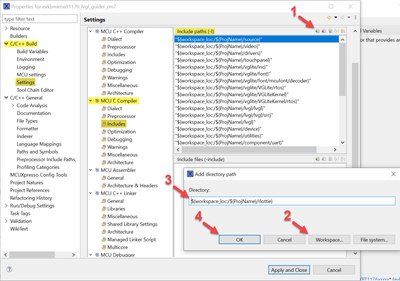

  1. Include the "lib" and "rlottie" folders as source folders by adding their path under:
    1. Project properties > C/C++ General > Paths and Symbols > Source Location.

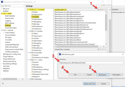

  1. Include the rlottie folder as include path by adding its path under the following two compilers' include paths:
    1. Project properties > C/C++ Build > Settings > MCU C++ Compiler > Includes > Include Paths.
  1. Project properties > C/C++ Build > Settings > MCU C Compiler > Includes > Include Paths.

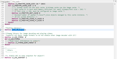

  1. Finally, enable the macro definition: #define LV_USE_RLOTTIE 1 under the "lv_conf.h" file on "source" to tell LVGL that we are using the rlottie library.

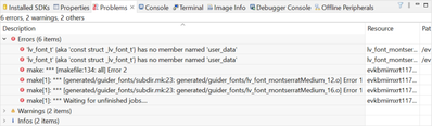

Note: There's a possibility that the following error shows up when compiling:
If this is the case, simply change the following macro in "source" > "lv_conf.h" from '0' to '1' to enable user data in the lv_font_t variable type:

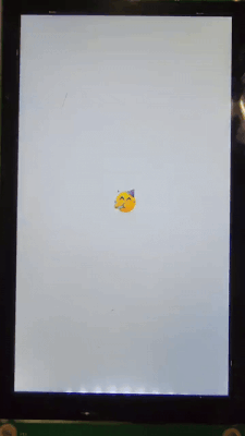

However, when executing the application, the screen goes black. Turns out, as soon as the application tries to execute the first rlottie instruction from the ".a" archived library, it is unable to execute anything, which causes the application to halt and get stuck on a black screen. This happens as soon as the application calls line 113 of the "lv_rlottie.c" file to construct the rlottie widget: (This file is under <project folder>\lvgl\lvgl\src\extra\libs\rlottie)
But there was no issue when building the application, so what gives?

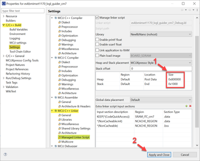

Well, the Rlottie library is quite memory heavy, so we also need to provide it with memory according to its requirements. We can do this by increasing the heap and stack size from their "default" state to something like 0x800000 for the stack and 0x1000 for the heap. These values are what GUI Guider provides to its projects when using Rlottie widgets.
With this, the MCUXpresso project will now have the rlottie libraries enabled, and also have enough memory to successfully debug/run the project on the i.MX RT board.
