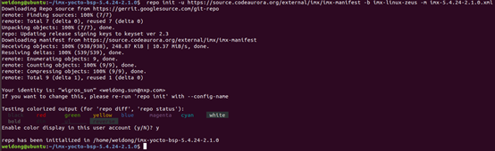

3. download yocto source of L5.4.24_2.1.0
# mkdir ~/bin
# curl https://storage.googleapis.com/git-repo-downloads/repo > ~/bin/repo
# chmod a+x ~/bin/repo
# export PATH=~/bin:$PATH
# mkdir imx-yocto-bsp-5.4.24-2.1.0
# cd imx-yocto-bsp-5.4.24-2.1.0
# repo init -u https://source.codeaurora.org/external/imx/imx-manifest -b imx-linux-zeus -m imx-5.4.24-2.1.0.xml
# cd .repo/manifests
# gedit imx-5.4.24-2.1.0.xml
         Modify git to https like below:
  <remote fetch="https://git.yoctoproject.org/git" name="yocto"/>
  <remote fetch="https://github.com/Freescale" name="community"/>
  <remote fetch="https://github.com/openembedded" name="oe"/>
  <remote fetch="https://github.com/OSSystems" name="OSSystems"/>
  <remote fetch="https://github.com/meta-qt5"  name="QT5"/>
  <remote fetch="https://github.com/TimesysGit"  name="Timesys"/>
  <remote fetch="https://github.com/meta-rust"  name="rust"/>
  <remote fetch="https://git.openembedded.org"  name="python2"/>
  <remote fetch="https://source.codeaurora.org/external/imx" name="CAF"/>
Save it and exit.
# cd ~/ imx-yocto-bsp-5.4.24-2.1.0
# repo sync

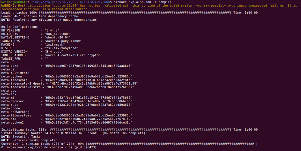

4. compiling nxp-wlan-sdk
# DISTRO=fsl-imx-xwayland MACHINE=imx8mmevk source imx-setup-release.sh -b build-xwayland
# bitbake nxp-wlan-sdk -c fetch

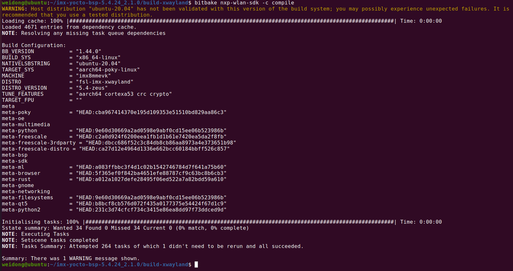

# bitbake nxp-wlan-sdk -c compile
done:
Then you can continue to compile imx-image-full
# bitbake imx-image-full
Hope above steps are helpful for you.

Actually this is not helpful at all as you failed to read the very title of post.
I am building under WSL2 (Windows Subsystem for Linux) NOT a VMplayer. Now that Microsoft supports native Linux under Windows 10 there is no need for VM Player, VM workstation or Virtual Box. WSL2 replaces all these and by the way runs much faster.
I posted this for those building yocto on Windows machines ... and it works very well thank you.
