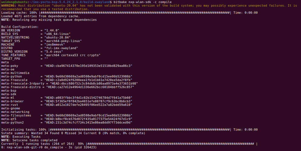

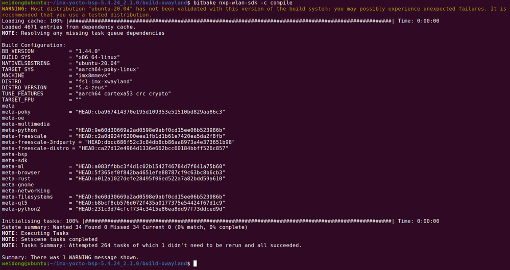

4. compiling nxp-wlan-sdk
# DISTRO=fsl-imx-xwayland MACHINE=imx8mmevk source imx-setup-release.sh -b build-xwayland
# bitbake nxp-wlan-sdk -c fetch
# bitbake nxp-wlan-sdk -c compile
done:
Then you can continue to compile imx-image-full
# bitbake imx-image-full
Hope above steps are helpful for you.
