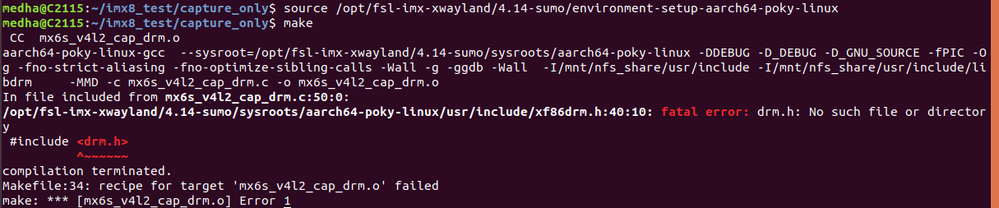

I am trying to compile the mx6s_v4l2_cap_drm.c
/opt/fsl-imx-xwayland/4.14-sumo/sysroots/aarch64-poky-linux/usr/include/xf86drm.h:40:10: fatal error: drm.h: No such file or directory
#include <drm.h>
compilation terminated.
Makefile:34: recipe for target 'mx6s_v4l2_cap_drm.o' failed
make: *** [mx6s_v4l2_cap_drm.o] Error 1
Error log
I have searched the file in target root file system.  Not found
Have you faced similar issues?
Ramesh
14,911 Views
prasad_imx8
Locally include it from the linux kernel (copy paste the header file)
And why are you compiling IMX6 (you are using IMX8 right?)
