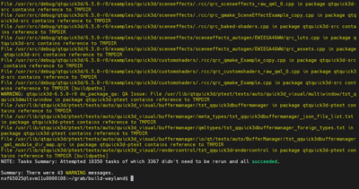

Hello Community
I'm trying to build the Yocto full build image of L6.1.22_2.0.0 in Ubuntu 20.04. using the build command : bitbake imx-image-full by following L6.1.22_2.0.0_LINUX_DOCS.
I am getting the bellow build error.
ERROR: Task (/home/user/imx/imx-yocto-bsp/sources/poky/meta/recipes-core/glibc/glibc-locale_2.37.bb:do_package) failed with exit code '1'
attaching the complete build logs for your reference.
Please help me in solving this issue.
Thank you

K_Varun
Dear Linux Community,
I am encountering an issue while building the image and need some assistance. Despite trying various approaches, I am still facing the following error during the build process: attaching the complete log-cat for better reference.
error:
ERROR: glibc-locale-2.39+git-r0 do_package: oe_runmake failed
ERROR: glibc-locale-2.39+git-r0 do_package: ExecutionError('/home/user/imx/imx-yocto/build-xwayland/tmp/work/armv8a-poky-linux/glibc-locale/2.39+git/temp/run.oe_runmake.787591', 1, None, None)
ERROR: Logfile of failure stored in: /home/user/imx/imx-yocto/build-xwayland/tmp/work/armv8a-poky-linux/glibc-locale/2.39+git/temp/log.do_package.787591
I am following the steps provided in the READ ME for building the image, which can be found here: https://github.com/nxp-imx/imx-manifest.
Could anyone guide me on how to resolve this issue?
Looking forward to your help.
