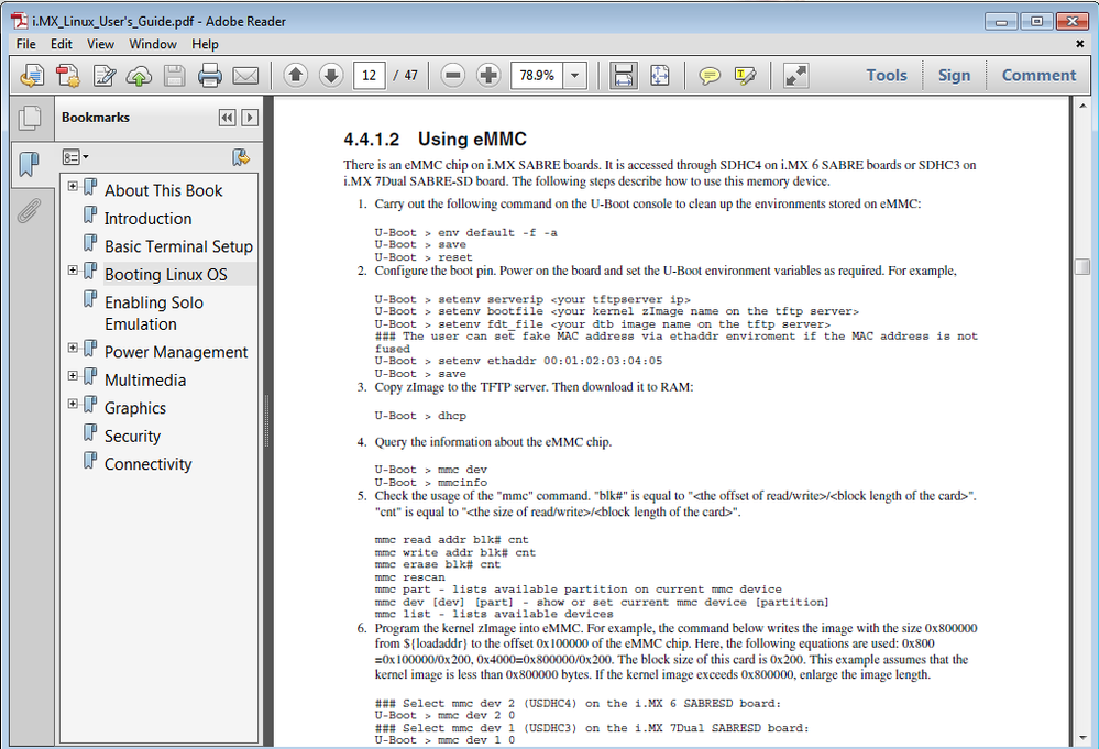

daiane_angolini
take a look if this is what you've looking for. The pdf file is i.MX_Linux_User's_Guide.pdf and it's under the Doc Bundle, in this case it's for fsl-yocto-3.14.38_6ul-ga.
I prefer you download the doc from the same version you're using, and from website.
2,891 Views
daiane_angolini
I'm sorry, just realized I got confused with another question I'm working with. You are targeting NAND
(not eMMC). I was not able to find an explicit how-to NAND (as we have for eMMC), but all the information needed (map) is in the same document.
