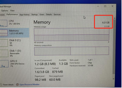

I got two question feedback from end customer, in win10IOT imx8mp plaftorm
1. the ddr show wrong size, our platform use 3GB ddr only , but it show up 6GB, how to modify it ?

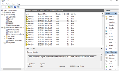

2. there are too many disk warning(show as below ) , what cause the warning ? Does there anyway to fix it ?
A: Are you using NXP board or customer design board? If customer design is 3GB, have them modify in the source code? Which version BSP are they using?
A: Warning will not effect using, you can ignore them.

HI Rita:
Thanks for reply.
For issue one, we use customer board, and modify the ddr config in bootloader , but I don't how to change the 6GB show in windows.
We use BSP: w1.3.0
1,571 Views
Rita_Wang
I email to you how to modify in the case 00632510, please have a check, any questions contact us freely.
1,630 Views
Rita_Wang
Got it, I will help confirm
