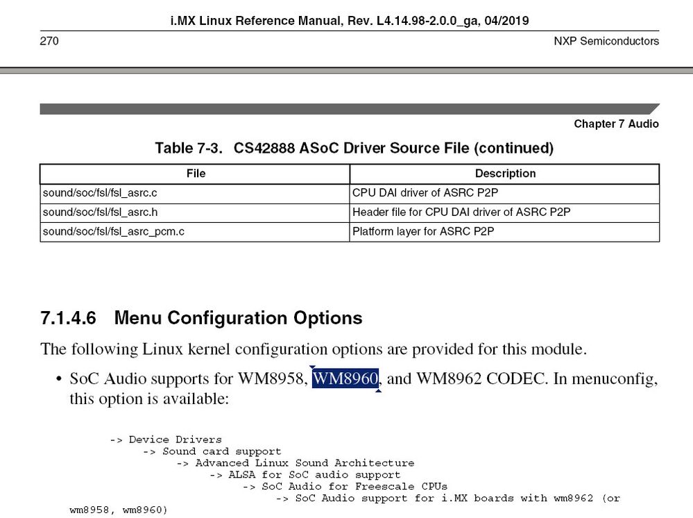

I have integrated wm8960 codec in place of tlv320 codec which is default present in phytec segin imx6ul board.
I made all the necessary changes in dts .And i can observe that i2cdetect also shows the UU at the at the address 1a which is the address of wm8960 codec .By this i confirmed that wm8960 codec driver is in use and by codec.
But after it is detected, if i am checking alsamixer and run the audio wav file , i am getting the error sound card not detected and alsamixer is not available.
please share the details where are the changes i should make to make the sound card detected, and which are the drivers responsible for codec and sound part.

dhanushvenugopa
Hi igorpadykov,
If during compilation in menuconfig i could not find the sound card driver
for wm8960 ,there is sound card driver for wm8962 ,now i can i enable the
sound card driver for wm8960.
since i didn't enable this sound card driver I could not access the
alsamixer and aplay command.Please suggest me the solution ASAP.
SoC Audio for Freescale CPUs
      • Common SoC Audio options for Freescale CPUs: ***
SoC Audio for Freescale i.MX CPUs
      • SoC Audio support for Freescale i.MX boards: ***
Generic ASoC Sound Card with ASRC support
6,039 Views
