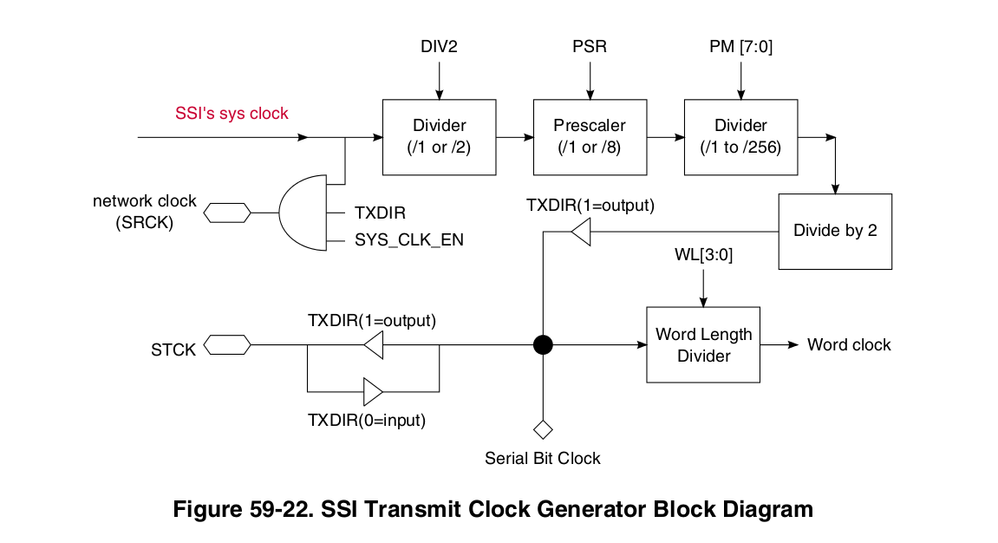

In this figure we can see that ssi's bit clock comes from ssi's sys clock,but where is ssi's sys clock from?
What is the relationship between ssi's sys clock and ssi_clk_root?

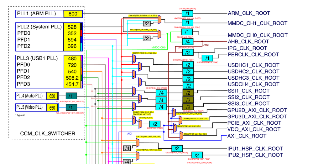

We can found the ssi_clk_root in the following figure.(ssi1_clk_root、ssi2_clk_root、ssi3_clk_root).

Actually, the SSI sys clock and ssix_clk_root are the different wordings for the same thing. This sys clock comes from the clock controller module, it is ssi1_clk_root for the SSI1 module, ssi2_clk_root for the SSI2 module and ssi3_clk_root for the SSI3 module.
