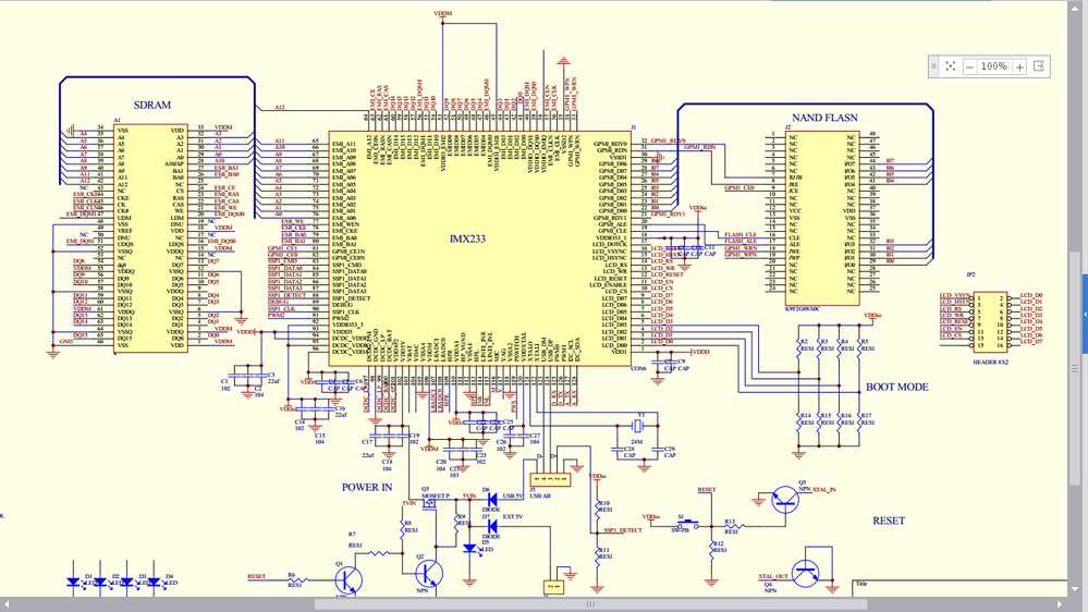

stevenshan
schematic.pnghi ,igor
I make a Printed Circuit Board ,and now the result is not good,which i had tested in below,i wish you can help me.
5V in PIN102 ---VDD5V ,VDDIO --3.126V ,VDD ---1.228 ,VDDA--1.788V ,PIN119 PWS  is 2.22V, VDDM is cycle by 0.26V-0.399V,DC-DC 4P2 1.19V.
boot0--boot4 is all 0V , crystal oscillator is 24V tested by oscilloscope .
I think there are some problems with my circuit,can you help me?
