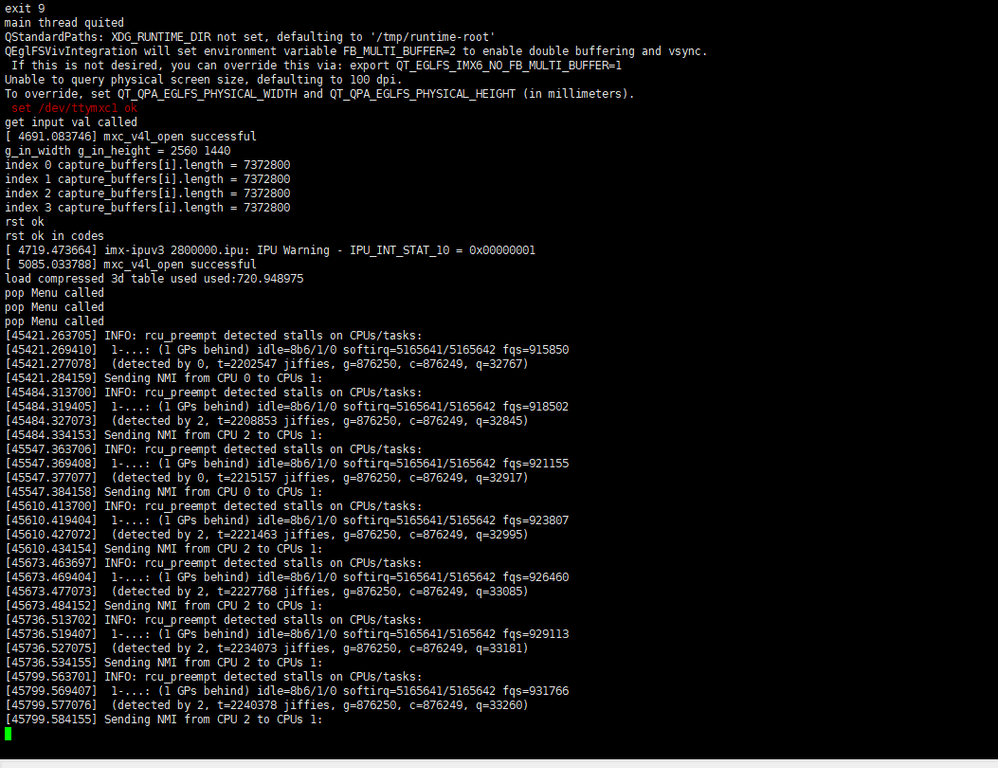

when my application keep on runing about 10 h,cpu stalls

the kernel version is 4.14.98, the cpu is imx6q , who can help me, thanks a lot
2,015 Views
b36401
Possibly there is some memory leakage and lack of the memory hangs the process.
Please try to monitor memory use during the running of the system.
I mean you can do something like "cat /proc/meminfo" every hour in background.
Also possibly bad RAM causes the process to hang.
Please perform DDR stress test.

chenghaibo
after calibrate the ddr3 and use the params, the board nerver show this error message again
