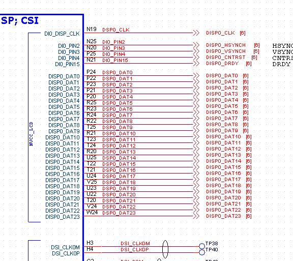

0: I want to use RGB888 to display video.
1:what is the sequence of the RGB888 to the pin of IMX6Q? it is mean,which of the DISP0_DATx map  to R[0:7]?Also to G[0:7],B[0:7]? And can the map change difference sequence in other order between DISP0_DATx and RGB[0:7]?
THANKS.
2,169 Views
Yuri
  Please refer to section 4.11.10.4 (IPU Display Interface Signal Mapping) of the Datasheet.
