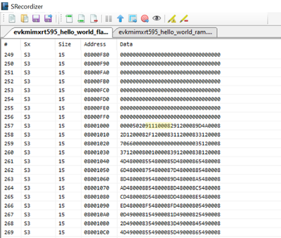

Do you know the srec file? If you generate the .srec file, you can find your app address, the address will let you see the memory area, about the address memory map, you can check the RT595 RM:
flash is the XIP code, RAM is the non-XIP code.
Q2.How does BOOT ROM check the address of APP, and how to distinguish whether it is flash or RAM?
=>kerry: check the resetISR address
Flash generated code, you can see the resetISR is in the flash:
RAM code:
resetISR is in the RAM address
