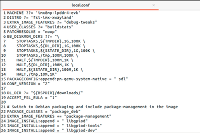

step1 : in local.conf file i added following packages---------->
IMAGE_INSTALL:append = " libgpiod"
IMAGE_INSTALL:append = " libgpiod-tools"
IMAGE_INSTALL:append = " libgpiod-dev"

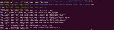

step 2: i build the  toolchain
step3 : 1st I try to add the application to control gpio for that i taken a reference of main.c : https://variwiki.com/index.php?title=MX8M_GPIO  from variscite

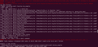

when i tried to add this application in my recipe at that time i am getting undefined reference errrors.
So i decide to go with creating makefile for my code. for that also I'm getting same errors.

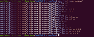

even i check can cross compiler includes the libgpiod lib or not , it is present
