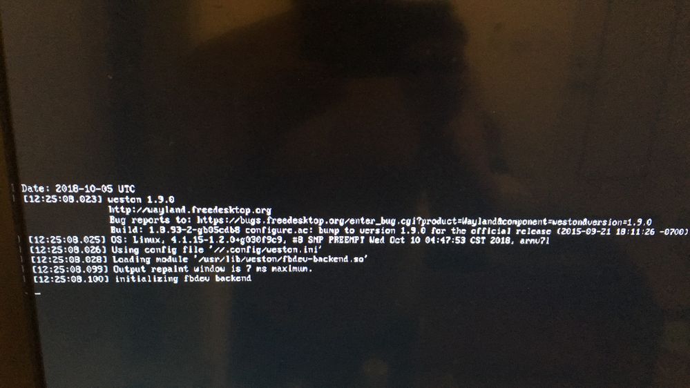

Hi Community,
I'm working on i.MX6 Quad sabre-SD and build weston wayland by yocto project.
Now my HDMI can just show logo and stuck at below picture (Please see attached boot_video.mp4 and log.jpg).
And I had modified weston.ini with the following content.
[core]
idle-time=0
[output]
name=HDMI1
mode=173.00 1920 2048 2248 2576 1080 1083 1088 1120 -hsync +vsync
And I tried to run "/etc/init.d/weston start" then HDMI will display the black screen.
Question:
  1. Why HDMI display cannot work after I execute "/etc/init.d/weston start"? And how can I fix it?
  2. How can I start Weston Wayland desktop automatically, I do not want to execute the command to start Weston every time.
Thanks in Advanced!
2,293 Views
Bio_TICFSL
Hi tsung,
Please modify /etc/default/weston (note: this only change UI resolution not HDMI output )
Weston config needs to changed to match the panel orientation, in the root file system
DESKTOP_SHELL_WINDOW=1080x1920
