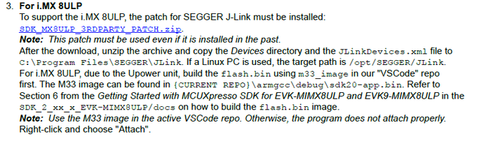

danielchen
Hi @Dhaval_Shiroya
You can refer to AN14120 for how to flash the image on i.MX8ULP.
