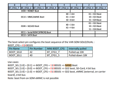

My hardware is currently in internal boot mode and when I toggle the BOOT_SEL1 pin, it starts booting from nand but here is no support for emmc mode here as shown in var-som-solo datasheet (refering VAR-SOM-SOLO_DUAL_v1_X_datasheet_v103) as shown below
My question is that if I go to fuse mode somehow, can I boot from emmcblk0boot0 and emmcblk0boot1 partitions or not? I can't find an concerete document for this specific use case for imx6solo based var-som-solo module, any relevant reference will be very helpful.

From the table attached seems like it's the HW configuration rather than the fuse need, it says that it can boot from eMMC populated on carrier board, you should ask your board vendor specifically if you can rework your HW to boot from SOM eMMC, otherwise, you could burn the fuses as said.

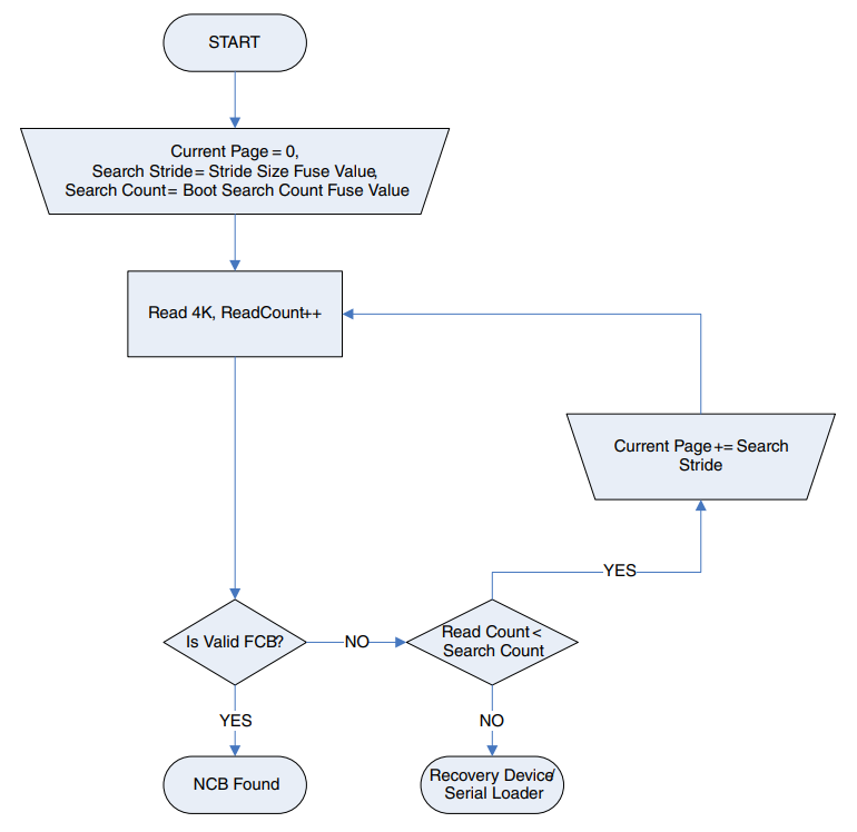

For the NAND corruption, you should modify the image by yourself, the processor supports the feature of look in further page numbers until find a correct Boot Control Block. If there isn't a valid BCB, the processor jumps to serial download.

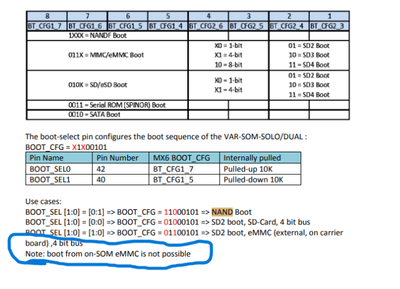

Yes, Its the hardware configuration and I already mentioned it above. Its the internal boot mode where boot mode is selected by external gpio pin. But var-som-solo datasheet says that its not possible to boot from emmc as shown in image below
Now, my question is simple, if we can boot from emmc in fuse mode? The answer you have given is very high level and I am unable to extract any information from it. Can you please send some reference or detial answer here.
