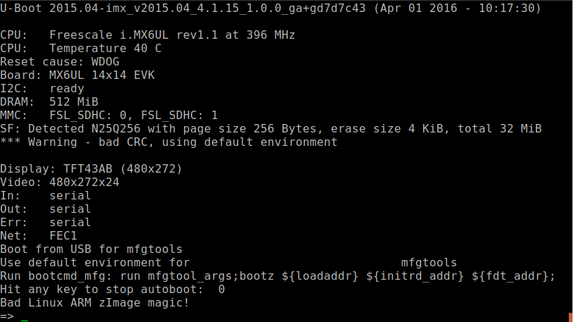

I am trying to flash stock uboot to the built-on QSPI NOR FLASH  of my iMX6ULEVK 14x14 board.
  • I already put the jumpers in the proper position (Serial Download Protocol and Boot from QSPI flash
  • I downloaded stock image and also git code of uboot
I would like to confirm some things first:
Q1. Is this file (u-boot-imx6ulevk_qspi1.imx) the right one? I took it from this image: L4.1.15_1.1.0_ga_images_MX6ULEVK
Q2. Why I cannot find mx6ulevk within the uboot git. (remotes/origin/imx_v2016.03_4.1.15_2.0.0_ga) (I didn't find
L4.1.15_1.1.0_ga)
Q3. ./uuu -b qspi [uboot-qspi.imx] hangs.
Q4. Is it, in fact, uuu the latest mfgtools?
Since I didn't find the mx6ulevk in the uboot source, I tried to flash the one from stock image.
1. Trying to flash uboot.imx only ...
 sudo ../uuu -b qspi u-boot-imx6ulevk_qspi1.imx

And in the serial console says:
I can perform reset command or hard reset from board and go back to same state.
Q5: What does "Bad Linux ARM zImage magic!" means?

Now we can see, the "Done" outputs and then the console returns (which is a good sign).
In the serial terminal I see this:
If I perform reset command or hard reset from board, the serial outputs hangs.

Yes it is the correct one, also UUU is the latest MFGtool, for it to work properlly it needs the fastboot utility to be enabled in uboot, unfortunately old version of uboot doesn't support these, it would need a custom script for it to work, similar to what is done here:
https://github.com/NXPmicro/mfgtools/issues/46
Thank you,
Aldo

Ok, I'd like to use a newer version that can support it.
I am trying with this (remotes/origin/imx_v2017.03_4.9.11_1.0.0_ga), however, I cannot make a proper defconfig.
I tried:
make mx6ul_defconfig
make mx6ul_14x14_evk_defconfig
make mx6ul_evk_defconfig
It says no rule to make target.
Which git repository and target should I use?

Sorry for the delayed response, please take a look to the attached "i.MX_BSP_Porting_Guide.pdf" in section 3.1.1 How to build U-Boot in standalone environment.
I'll also attach the UUU documentation, take a look to the section 10 Uboot config requirement.
