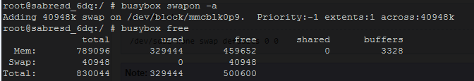

linshuanyi
Hi John,
I mean
busybox mkswap <partition>
busybox swapon <partition>
and I tried several ways to swapon the partition
you can see the picture below,it seems that I have successfully swapon /dev/block/mmcblk0p9
However,this status only remain until next boot.
I have manually modified fstab.freescale to add information for /dev/block/mmcblk0p9 as a swap partition,and copied its content to /etc/fstab,
I really can't figure out what's the problem.
I also tried to use SD card as a swap partition,but it also failed when I tried to swapon :smileysad:
can you give me some advices?
