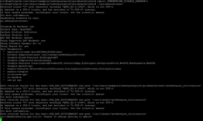

I'm trying to show content on the small screen (TFT3P5581-T) connected to the evaluation board. However nothing shows up on the screen, when I'm trying to run any of the examples from the "QtWebEngine browsers" - instead i get the following error:
I have tried to run the command: "export QTWEBENGINE_DISABLE_SANDBOX=1
which changed the error to:
The resistors determine whether it should be HDMI or MIPI have been moved, and I have an image, that is showing a simple screen on the display indicating that the connecting the display is working.
Now I want to build a new image with the following settings:
  • DISTRO=fsl-imx-wayland
  • MACHINE=imx7ulpevk
  • bitbake imx-image-full
I have added to local.conf:
IMAGE_INSTALL:append = " packagegroup-qt6-webengine"
Any suggestions how I get the demonstration to run and show on the screen.

Are you using the correct device tree?
The device tree to use that Display should be imx7ulp-evk-mipi.dtb
Best Regards!

HenrikZ
Hi @Chavira
To setup the fdtfile I stopped the uboot process and entered the following at the prompt:
=>  setenv fdtfile imx7ulp-evk-mipi.dtb
To show that it succeeded to set the value i tried:
=>  printenv fdtfile
Which provided the follwing result: "fdtfile=imx7ulp-evk-mipi.dtb
And finally I saved the change:
=>  saveenv
Even though I think I have chosen the device tree, the error still persists as shown in the picture below. You can see in the top of the picture, that I have ran the command: export QTWEBENGINE_DISABLE_SANDBOX=1.
The error description in the picture does mention "character encoding" a few times. Could that be the issue since it says "Qt depends on a UTF-8 locale..."?

Chavira
HI @HenrikZ!
You don´t see nothing in the display when is booting?
I notices that the correct variable for iMX7ULP-EVK board is fdt_file.
After that you should be able to see the display working.
1,495 Views
HenrikZ
Hi @Chavira
That made a difference, now I see the splash screen when boot and the screen, and I can start the demo examples from NXP.
Thanks for the help.
