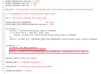

I attempted to build a Scarthgap image for the i.MX93 platform using the following command:
bitbake imx-image-multimedia
However, the build fails with the error below:
ERROR: _exec_cmd: install -m 0644 -D /osm-imx93/imx93-yocto-bsp/build_dir/tmp/deploy/images/osm-imx93/imx93-11x11-evk_m33_TCM_low_power_wakeword.bin/osm-imx93/imx93-yocto-bsp/build_dir/tmp/work/osm_imx93-poky-linux/imx-image-multimedia/1.0/tmp-wic/boot.2/imx93-11x11-evk_m33_TCM_low_power_wakeword.bin returned '1' instead of 0
output: install: cannot stat '/osm-imx93/imx93-yocto-bsp/build_dir/tmp/deploy/images/osm-imx93/imx93-11x11-evk_m33_TCM_low_power_wakeword.bin': No such file or directory
It appears that the file imx93-11x11-evk_m33_TCM_low_power_wakeword.bin is missing from the deploy directory.
Could you please advise on how to resolve this issue?

Hi @rahul_raja
If you are using custom machine, please refer the evk setting about mcore demos.
$ cat meta-freescale/conf/machine/imx93-11x11-lpddr4x-evk.conf
#@TYPE: Machine
#@NAME: NXP i.MX 93 11x11 Evaluation Kit with LPDDR4X
#@SOC: i.MX93
#@DESCRIPTION: Machine configuration for NXP i.MX 93 11x11 EVK with LPDDR4X
#@MAINTAINER: Jun Zhu <junzhu@nxp.com>
require include/imx93-evk.inc
KERNEL_DEVICETREE_BASENAME = "imx93-11x11-evk"
KERNEL_DEVICETREE:append:use-nxp-bsp = " \
    freescale/${KERNEL_DEVICETREE_BASENAME}-aud-hat.dtb \
    freescale/${KERNEL_DEVICETREE_BASENAME}-boe-wxga-lvds-panel.dtb \
    freescale/${KERNEL_DEVICETREE_BASENAME}-flexio-i2c.dtb \
    freescale/${KERNEL_DEVICETREE_BASENAME}-flexspi-m2.dtb \
    freescale/${KERNEL_DEVICETREE_BASENAME}-i2c-spi-slave.dtb \
    freescale/${KERNEL_DEVICETREE_BASENAME}-i3c.dtb \
    freescale/${KERNEL_DEVICETREE_BASENAME}-inmate.dtb \
    freescale/${KERNEL_DEVICETREE_BASENAME}-iw612-otbr.dtb \
    freescale/${KERNEL_DEVICETREE_BASENAME}-ld.dtb \
    freescale/${KERNEL_DEVICETREE_BASENAME}-lpuart.dtb \
    freescale/${KERNEL_DEVICETREE_BASENAME}-mqs.dtb \
    freescale/${KERNEL_DEVICETREE_BASENAME}-mt9m114.dtb \
    freescale/${KERNEL_DEVICETREE_BASENAME}-rm67199.dtb \
    freescale/${KERNEL_DEVICETREE_BASENAME}-root.dtb \
    freescale/${KERNEL_DEVICETREE_BASENAME}-rpmsg.dtb \
    freescale/${KERNEL_DEVICETREE_BASENAME}-rpmsg-lpv.dtb \
UBOOT_CONFIG_BASENAME = "imx93_11x11_evk"
DDR_FIRMWARE_NAME = " \
    lpddr4_dmem_1d_v202201.bin \
    lpddr4_dmem_2d_v202201.bin \
    lpddr4_imem_1d_v202201.bin \
    lpddr4_imem_2d_v202201.bin \
WKS_FILE_DEPENDS:append:imx-nxp-bsp = " imx-m33-demos"
IMAGE_BOOT_FILES:append:imx-nxp-bsp = " \
    mcore-demos/imx93-11x11-evk_m33_TCM_low_power_wakeword.bin \
    mcore-demos/imx93-11x11-evk_m33_TCM_power_mode_switch.bin \
    mcore-demos/imx93-11x11-evk_m33_TCM_rpmsg_lite_pingpong_rtos_linux_remote.bin \
    mcore-demos/imx93-11x11-evk_m33_TCM_rpmsg_lite_str_echo_rtos.bin \
    mcore-demos/imx93-11x11-evk_m33_TCM_sai_low_power_audio.bin \
And https://git.yoctoproject.org/meta-freescale/tree/recipes-fsl/mcore-demos/imx-mcore-demos.inc?h=maste... , the m33 demos will be deployed into ${DEPLOYDIR}/mcore-demos/, you need adjust path.
