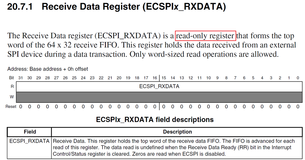

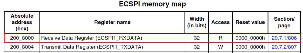

weidong_sun
Hello vemula,
See below, please!
0x200_8000 register is a read-only register, even if you access it, you can't write data to it.
Register is used to receive data, not control register, you don't need to configure it.
Hope the infromation is helpful to you.
Have a nice day!
B.R,
Weidong
