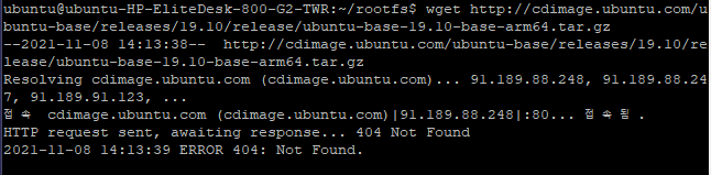

3. Download ubuntu rootfs
$ mkdir ~/rootfs && cd ~/rootfs
pdf: $ wget http://cdimage.ubuntu.com/ubuntu-base/releases/19.10/release/ubuntu-base-19.10-base-arm64.tar.gz
$ wget https://cdimage.ubuntu.com/ubuntu-base/releases/18.04/release/ubuntu-base-18.04.5-base-arm64.tar.gz
Change it and move on
$ mkdir ubuntu-rootfs
pdf: $ tar -xvf ubuntu-base-19.10-base-arm64.tar.gz -C ubuntu-rootfs
$ tar -xvf ubuntu-base-18.04.5-base-arm64.tar.gz -C ubuntu-rootfs

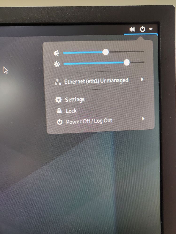

csoon-park
Thank you, teacher.
However, Ethernet connection and Internet connection are not available.
it is "imx8mpevk". Also, does this os install apt-get?

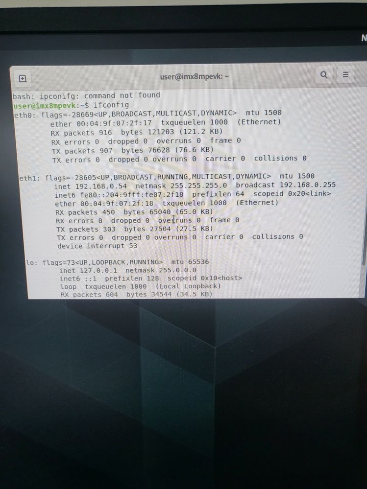

jimmychan
So, have you try to use ifconfig to set the IP address?

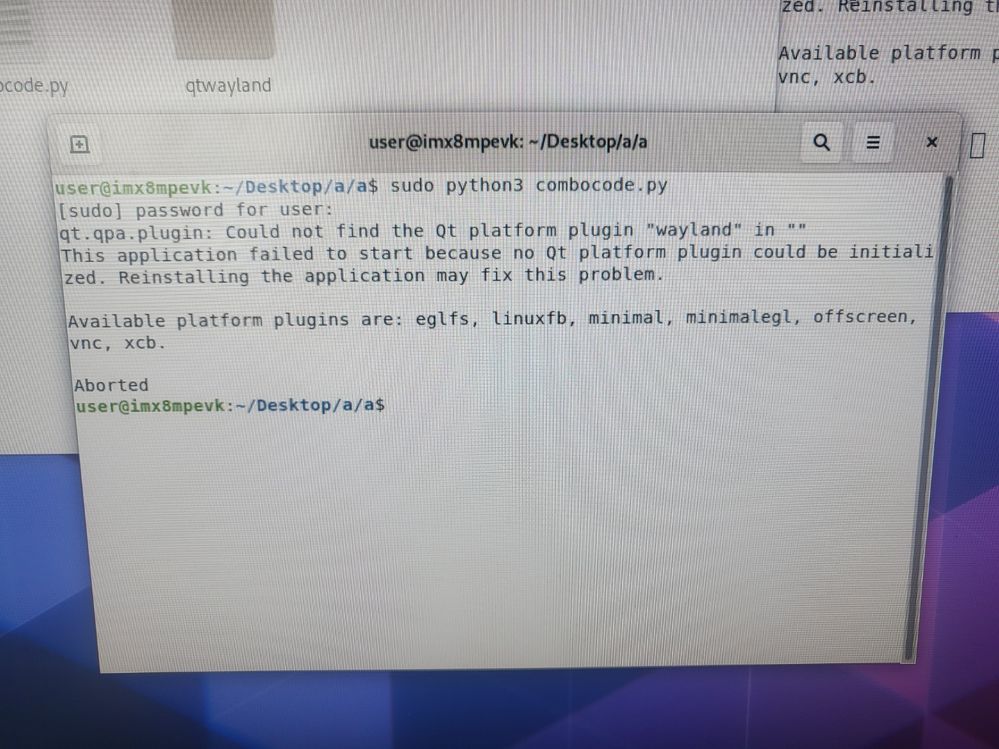

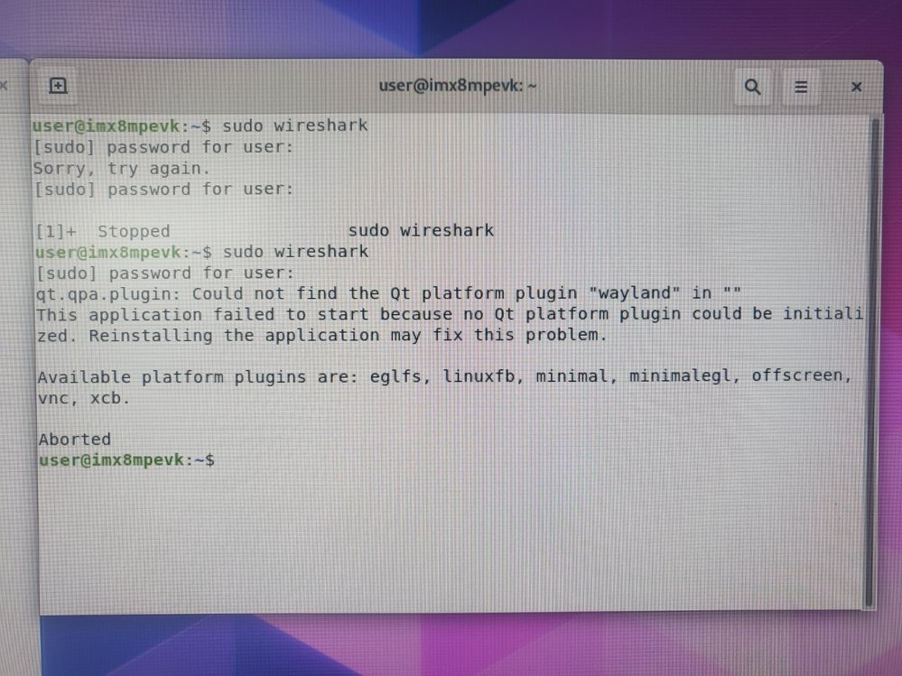

Doesn't this os run the "qt5" program?
I installed "pyqt5" with "sudo apt-get install python3-pyqt5".
https://community.nxp.com/t5/i-MX-Processors/imx8mpevk-meta-nxp-desktop-pyqt5-run-error/m-p/1369857/...
