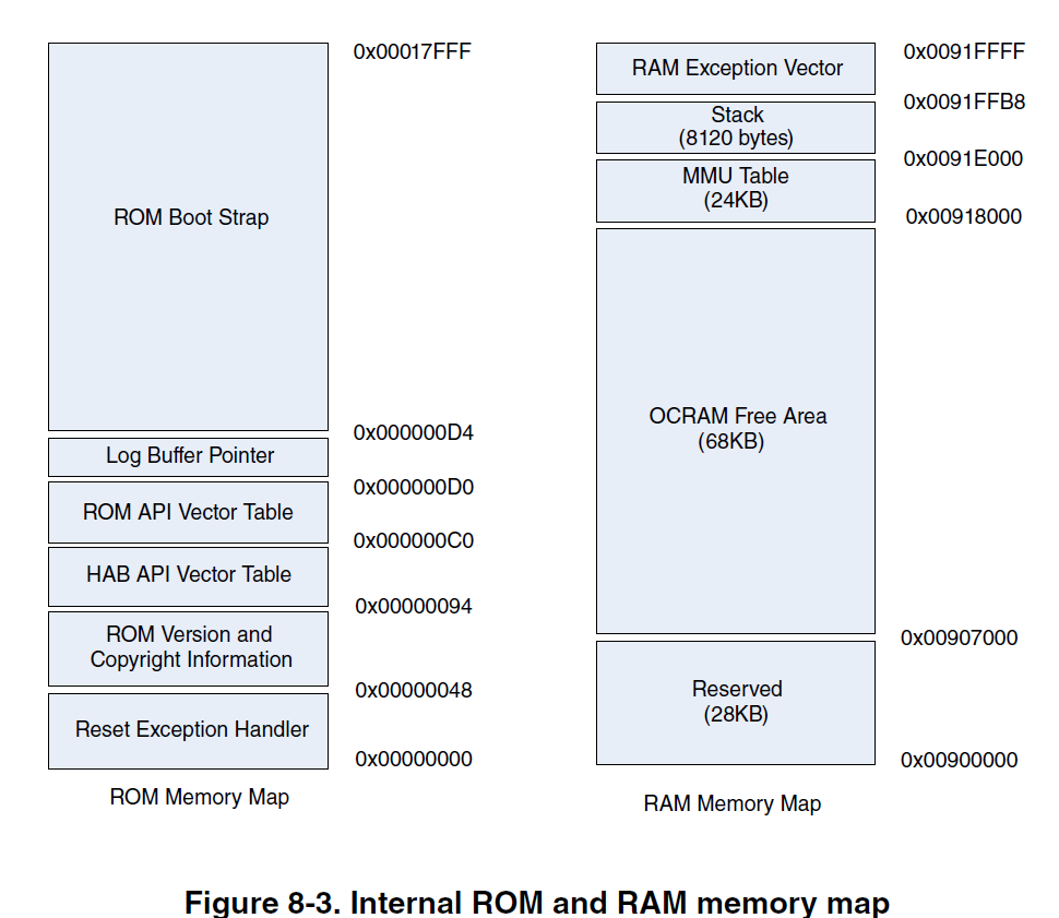

Environment of my Example:
MCIMX6D6AVT08AD + AI EVB
The address of my example is the start of the OCRAM, as pic shows.
From your log, you may load the .bin to a wrong place, you can check the  chip RM to find a right one.
Not sure about this, hope it will work, thanks!

Actually as per our board environment (printenv) the loadADDR is 0x12000000, thats why I chosen this address, On what basis this address can be selected, and if i choose an address which are places i need to update address in u-boot source code.
Can you give some brief steps to create our own standalone program, and run it on u-boot.
Thank you.,
