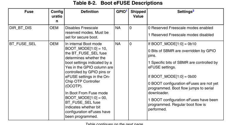

raymondwang
Senior Contributor I
As a brief :
1. boot from fuse mode always check CPU's Fuse setting to decide which device as a boot device;
2. serial downloader mode always enter MFG mode in despite of Fuse setting or GPIO override setting;
3. internal boot mode can use external GPIO setting to override fuse mode setting,so it's alternate setting to change boot device without
  change Fuse setting (Fuse setting is OTP)
Mode 1 and Mode 3 are behavior of eFuse Config BT_FUSE_SEL not blowed. See below table for details.
It means a flag of Fuse setting is valid or not for CPU BOOT ROM ( I guess that)
So for you application, I assume no Fuse settings was blowed, If you want to boot from SATA,
Step 1: change boot mode to internal boot mode;
Step 2: Change GPIO default setting mapping to BOOT_CFG1 BOOT_CFG2 BOOT_CFG3 BOOT_CFG4
These 4 BOOT_CFGs are 8bit setting ,totally 32bit and mapping to 32 GPIO setting.
BOOT_CFG1 should be 0x20
BOOT_CFG2~BOOT_CFG4 setting should be set per you application.
