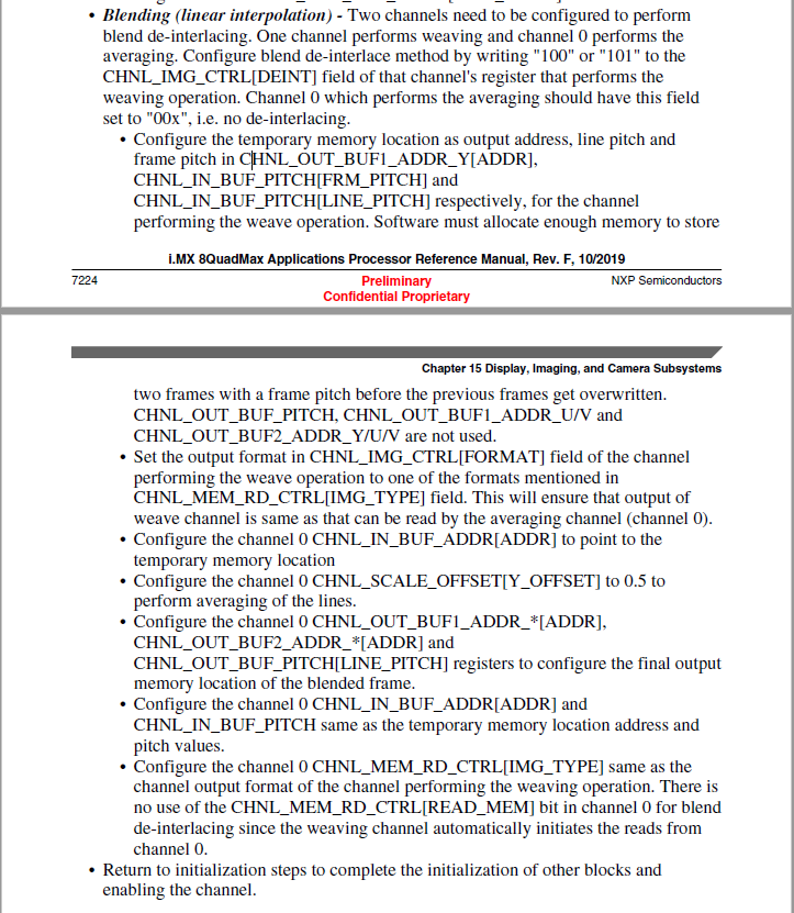

simonlin
Hi igorpadykov
I check p.7224 in iMX8QM_RM_Rev_F.pdf
It support blend de-interlace mode
System always repeat below log and doesn't display preview after I set blending mode

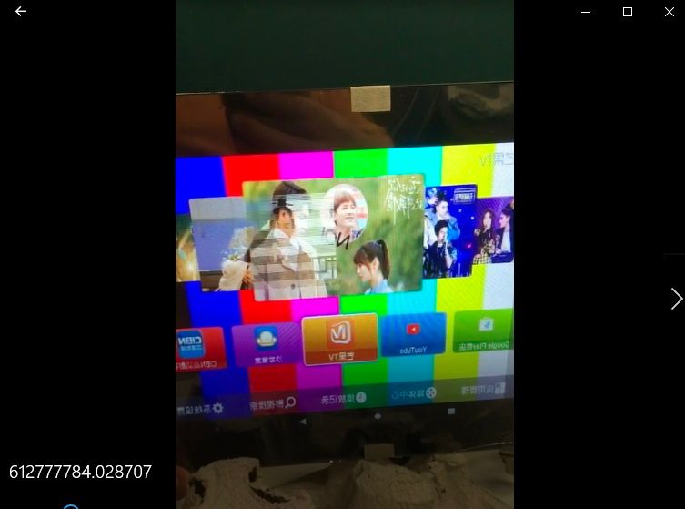

simonlin
Hi igorpadykov
Thanks for your response
Do you have any suggestion for weaving mode issue as below photo
