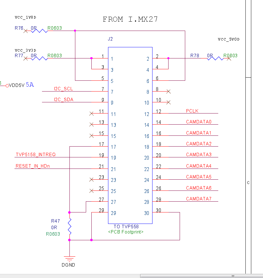

Hi all,
I'm using tv decoder(tvp5158) on imx27, using the 4 channel half D1 mode.
I config the register by using i2c, and set the interface param as below:
param->Vsync_pol = 0x0;
param->clk_mode = 0x0;//gated
param->pixclk_pol = 0x0;
param->data_width = 0x1;
param->data_pol = 0x0;
param->ext_vsync = 0x1;
param->Hsync_pol = 0x0;
param->width = width - 1;
param->height = height - 1;
param->pixel_fmt = IPU_PIX_FMT_UYVY;
param->mclk = 54000000;
/* setup cropping */
when insert the mode, I use the mxc_v4l2_capture test tool to capture image, but I always get the error log

Attachment file is my tvp5158 driver, anyone can give me some advice?
Please help me.

I am not sure how tvp5158 and tvp5150 are similar, but I would suggest you to take a look at the latest kernel that has support for the mx25 visstrim board, which is connected to a tvp5150:
https://git.kernel.org/cgit/linux/kernel/git/torvalds/linux.git/tree/arch/arm/mach-imx/mach-imx27_vi...
The tvp5150 driver is located at:
https://git.kernel.org/cgit/linux/kernel/git/torvalds/linux.git/tree/drivers/media/i2c/tvp5150.c?id=...
Hope this helps.
Fabio Estevam

Sorry, I meant mx27 visstrim board.
2,388 次查看
zhangjay
Also provide the circuit diagram, there is no Vsync and Hsync on TVP5158.
