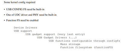

目前线索:uuu.pdf-> FBK: Android fastboot protocol, implement at initramfs. See project imx-uuc ,需要在/init中手动挂载以下脚本并获取udc设备手动启动fastboot监听,来源:imx-uuc->linuxrc

细节问题:目前挂载/sys之后还是不能获取到udc设备,在内核中打开了以下设备以及dwc3 platform还是不能找到udc中的设备,设备树暂时还未修改,dmesg报错dwc3未正常启动
Device Drivers
  USB support
    USB gadget support (very last entry)
      Mass storage
      Function filesystem (functionFS
      HID Gadget
    USB Physical Layer drivers
      Freescale MXS USB PHY support
sh-5.2# dmesg
[11.750414] dwc3 38100000.usb: Configuration mismatch, dr mode forced to gadget
[11.766399] platform 38100000.usb:deferred probe pending
