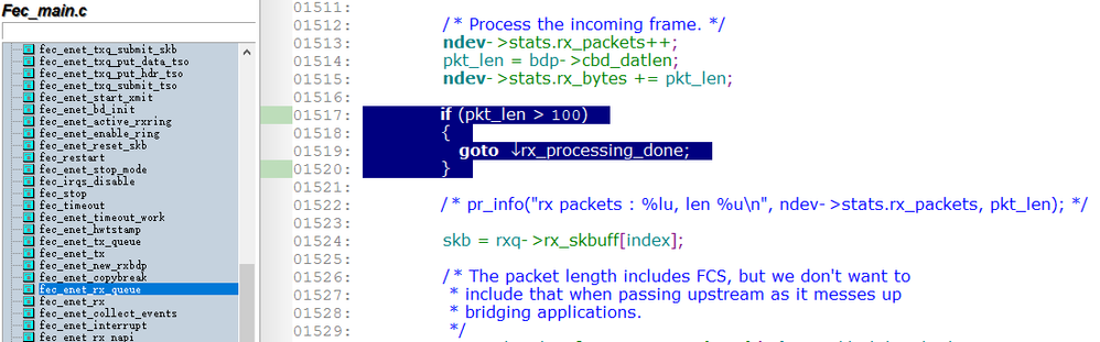

In order to fix this bug, i have try the following idea, but make no sense.
(1) even if the packets received in ENET module correctly, i will also discard them when the length is more than 100 bytes, please refer to the source code attached below, in order to verify that the root cause for this issue is not associated with CPU process capability.
(2) change the weight when use napi
netif_napi_add(ndev, &fep->napi, fec_enet_rx_napi, NAPI_POLL_WEIGHT/4);
(3) as far as i know, there is ERR004512, may be associated with this issue, but there is one doubt here i do not understand. when imx6 enet connect the other side (the side that sends these udp packets), this issue can be reproduced every time, but if let the same other side connect to one PC ethernet(RJ45), everything is good. and we get the average speed is about 160Mbps. the ERR004512 tell me the limited speed is about 470Mbps, more than 160Mbps, but that means the peak speed, not average speed ? those two concept is different ? Besides, if we reduce the send UDP speed from 160Mbps to 28Mbps, this issue can also be reproduced every time, so I guess this issue is not associated with UDP send speed, may be associated with our specific streame mode, but what is the root cause ? I have no idea to figure it out. .
