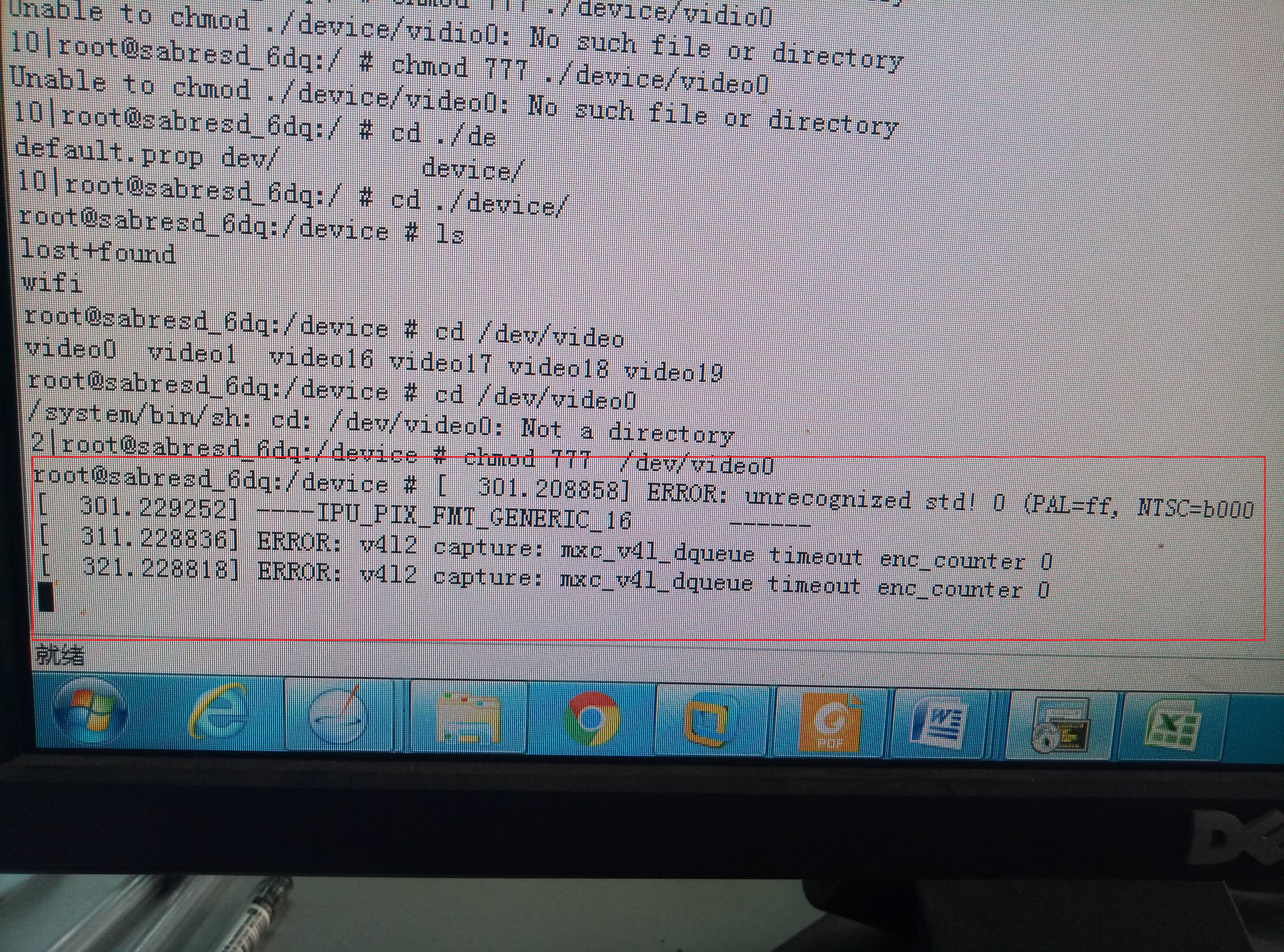

Hi all
   we use parall port to conect camera sensor(16bit), the clk,hsys and vsys are from camera sensor,when we use other plantform, the image perform well,but when use MX6q,there is no image output,the log is attached below,compared the same sensor with dfiffrent plantform,the orange waveform is correct by use i.Mx515,and the green waveform is not good by use Mx6q,the waveform is attached below,.hope your reply!

Hi gillian
both IPU modules for i.MX515 and i.MX6Q basically the same, so may be
useful to run and compare IPU/CSI settings with baremetal sdk examples,
zip can be found on below link
