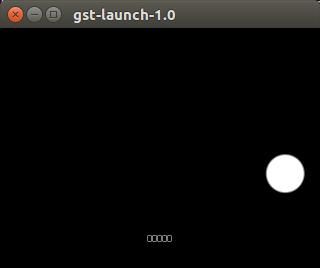

Hello,  I'm trying to add clockoverlay into my video stream.  However, the text displayed is not correct (i.e. it shows "boxy" character instead of time digits).  What's the issue? Fonts not found?  Please help.  I've attached the screenshot (see text in top right corner of BBB stream).

So I finally find what was wrong using the fontconfig-utils package
FYI fc-list can list the embedded fonts, and none was appearing ...
So what was missing is the package : liberation-fonts
Once installed fc-list could list the fonts and gstreamer textoverlay was then working ...
So guessing that you use yocto : add liberation-fonts into IMAGE_INSTALL of the image built

I've tried with textoverlay too but the same result.  How can I make sure that my fonts are in place and correct language dictionary?  I'm using Buildroot 2016.05.

I have exactly the same problem, attached is the "boxy" character you probably are talking about :tmp.jpg
have you figured out what was wrong ?
