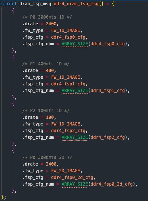

this question is about the IMX8MM_EVK, in the uboot code, the ddr4_timing.c have one struct ddr4_dram_fsp_msg that have three rate value config 2400, 400, 100.
And in the RPA files, there are only two frequency can be set.
do I need modify the RPA or the uboot code? @igorpadykov

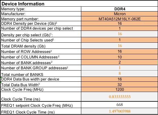

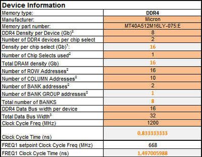

my board use two 16bit DDR as 32bit, so could you check the parameters in my RPA? is it correct?
@igorpadykov

igorpadykov
such configuration 2xMT40A512M16LY is used on NXP i.MX8M Mini DDR4 EVK board
i.MX 8M Mini Evaluation Kit DDR4 Design Files
RPA Tool for it   MX8M_Mini_DDR4_RPA_v15.xlsx
So if ddr test passed, no need for modifications in NXP uboot/linux codes for ddr. 
igor

3. I create one new board based on the imx8mm_evk in uboot, and I changed the ddr4_timing.c(from DDR tool), pmic init code(DDR4 voltage), IMX8M_DDR4 config. And the result is like I said at the beginning.
About my frequncy setpoint question, I don't understand that the evk using LPDDR4 and 100,400,3000 timing table in the timing file, and I change it to the DDR4 with 1066, 2400.
do I need to modify somthing for that?
Based on your experience, do i miss or do something wrong steps on it?
