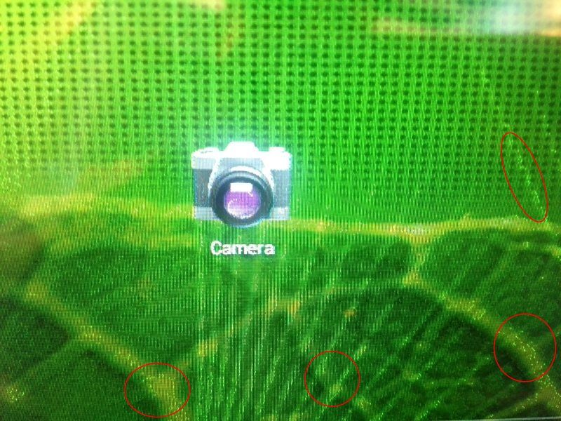

We found there's strange blink pixels on lvds screen sometimes.
We try to write the fb0/blank device to make the screen blank and restore it again,
and then found the blink pixels may disappears or appears randomly.
    root@sabresd_6dq:/ # echo 1 > /sys/class/graphics/fb0/blank
    root@sabresd_6dq:/ # echo 0 > /sys/class/graphics/fb0/blank
Here's the boot command
    root@sabresd_6dq:/ # cat /proc/cmdline
    console=ttymxc0,115200 androidboot.console=ttymxc0 androidboot.hardware=freescale init=/init video=mxcfb0:dev=ldb,1280x800M@60,if=RGB666,bpp=32 video=mxcfb1:dev=hdmi,1920x1080M@60,if=RGB24,bpp=32 video=mxcfb2:off fbmem=14M,28M vmalloc=512M ldb=dul1
This is screen with strange blink pixel --

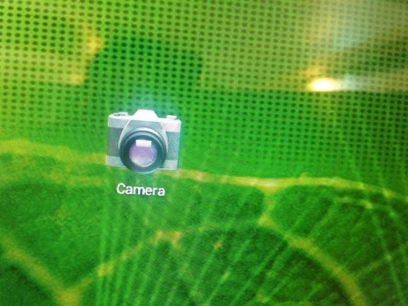

This is good screen --
Thank you!
Any suggestion will be appreciated!

issue may be caused by noise (one can decrease cable length or
LCD frame rate) or incorrect memory settings : for example
memory region overlapped with other reserved memory, such as GPU memory etc.
Also it is recommended to apply all latest fixes and updates for BSP,
as was on
https://community.freescale.com/message/320101#320101

And more, we use IMX6_JB43_111, gpu bugs in ICS should be fixed in this version, I think.
Today we have new progress --
If we change ldb=dul1 to ldb=sep0 in boot commands, we can not find the blink pixels now.
It seems not like a problem of noise or cable.
( But if using ldb=sep0, hdmi will be disabled, so we still have to use ldb=dul1 )

Hi, Igor,
Checked the patched files one by one manually, and confirmed all patches have been applied.
The problem is not fixed.
We're think about why to change ldb=dul1 to ldb=sep0 will fix this problem ...
