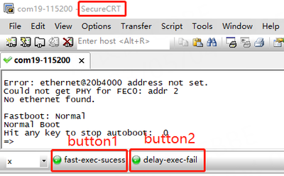

Below are the steps on i.MX6ULL-EVK board with "bad U-disk" to reproduce the issue:
1. Connect debug console and prepare two command Button in SecureCRT.  One of following command strings will be run when click a Button.
    Button "fast-exec-sucess" command string is: \rusb reset && usb tree && fatload usb 0 80800000 vmlinuz && fatload usb 0 83000000 imx6ull.dtb && fatload usb 0 83800000 initrd.img\r
     Button "delay-exec-fail" command string is: \rsleep 3 && usb reset && usb tree && fatload usb 0 80800000 vmlinuz && fatload usb 0 83000000 imx6ull.dtb && fatload usb 0 83800000 initrd.img\r
(the two command string almost the same except "sleep 3" ahead)
2.  Prepare three files named vmlinuz(6.3MB)/imx6ull.dtb(45KB)/initrd.img(8MB)(files size may not need the same), and place under the root directory of U-disk;
3. Power the EVK board, and if click the  Button "fast-exec-sucess"  when u-boot count-down, and you can see sucess to access the U-disk each time, log like:

4.  Power the EVK board, and if click the  Button "delay-exec-fail"  when u-boot count-down, and you can see fail to access the U-disk each time, log like:
