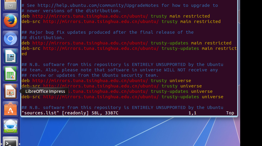

I have changed 163 to tsinghua.
i have some questions to ask you ,
as downlows,this ''which whether  is sill reseved?

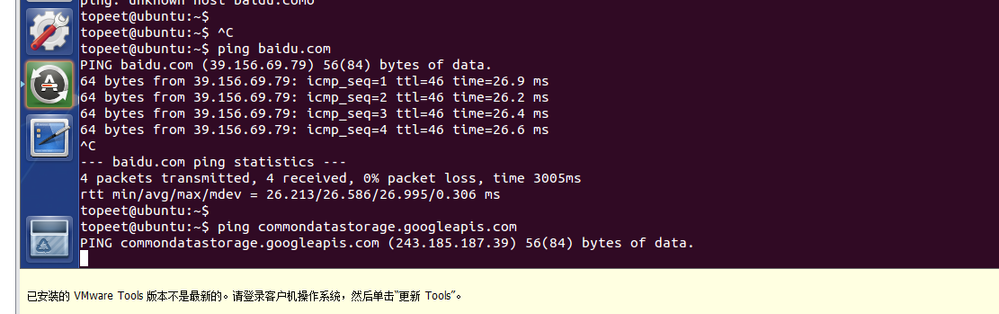

4,274 Views
zhangbaobing
ok ,thanks ,but my net can not  ping commondatastorage.googleapis.com,
and then ,what do i can test my connetivity.
but i can ping baidu.com,so what can i do ?

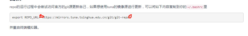

Rita_Wang
If you cannot download the repo from google, please try this one:
Git Repo | 镜像站使用帮助 | 清华大学开源软件镜像站 | Tsinghua Open Source Mirror
4,274 Views
zhangbaobing
  Ok,thanks
but I have a  question
my ubuntu uses source of 163,so i want to know whether to chang to the source of 163?
4,274 Views
zhangbaobing
or ,i will change my source of 163 to Tsinghua.
