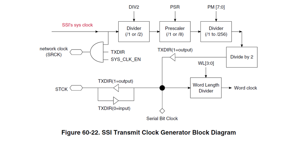

in 3.10.53 kernel:
CCM_CLKO1(audio i2s master)is 24MHZ ,   how to set to 11.2896MHzMHz
I change
imx_clk_set_rate(clk[pll4_audio_div], 541900800);
to
imx_clk_set_rate(clk[pll4_audio_div], 90316800); //8*11289600
question:
clk_get_rate(data->codec_clk) print the value is 11289600,
but the clock is still 22.5MHZ(11289600*2) by  oscilloscope

Hi Qiang
Which clock you are measuring MCLK or Bit clock? if it is bit clock (SSI clock) than output clock is divided based on DIV2, PSR and PM parameter configuration.
You can check

强王
HI Saurabh:
     Could you upload the document of this picture

saurabh206
Senior Contributor III
Hi Qiang
Please refer "IMX6DQRM.pdf"
60.7.4 SSI Clocking

强王
HI Saurabh and gusarambula:
I don't quite understand this picture
Can you tell me the code after the modification
1,308 Views
强王
HI Saurabh:
the board is imx6q sabresd
i  measure GPIO_0
