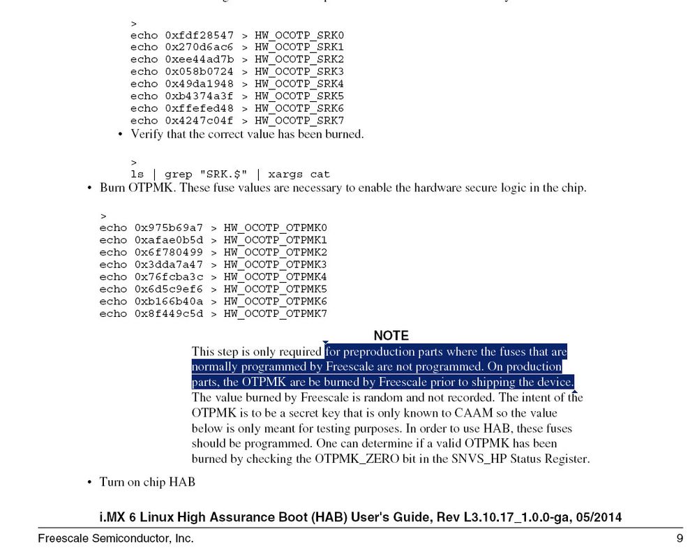

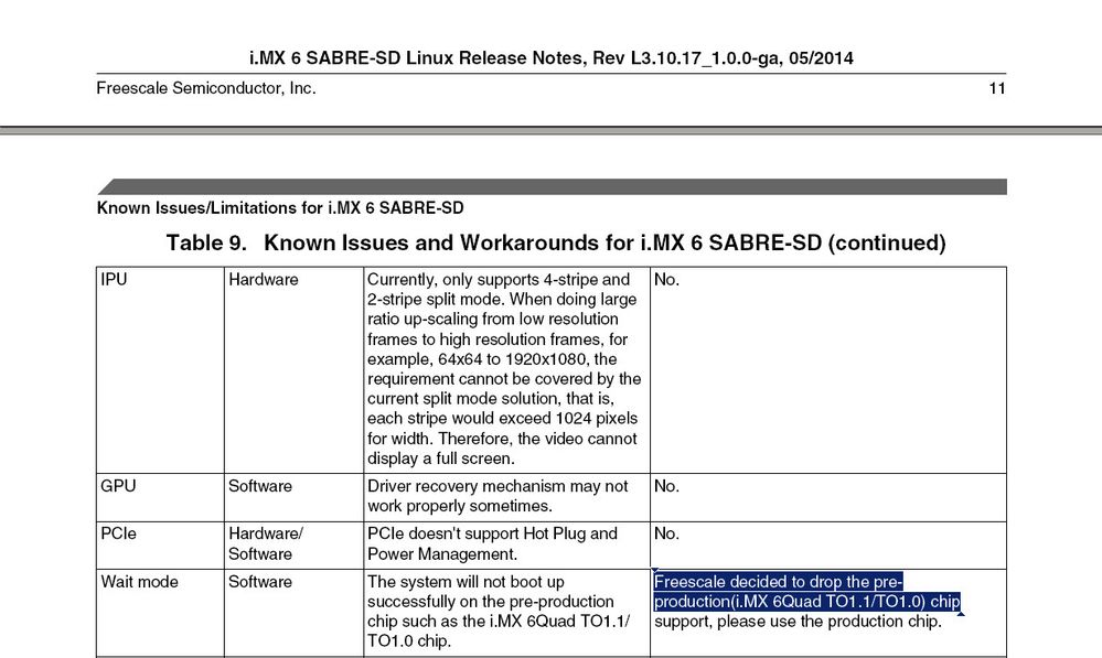

igorpadykov
Hi Ajay
i.MX6Q rev1.0 (preproduction parts) were not tested with
BSPs and may not work properly, refer to part of Release Notes
also on these parts OTPMK are not burned, from attached
i.MX_6_Linux_High_Assurance_Boot_(HAB)_User's_Guide.pdf
In general recommended to use latest GA release, not beta
L3.14.28_1.0.0_iMX6QDLS_BUNDLE
igor

ajaybande
Hi Igor,
Thank you for Reply.
I have flashed OTPMK register, Still I am getting same events.

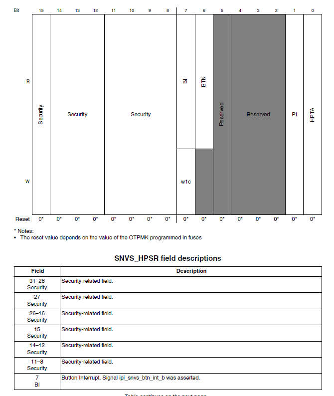

I have checked SNVS_HP Status Register, but I am not bale to interpret  is it correct or some thing is wrong?
SNVS_HP Status Register log:-
MX6QSABRELITE U-Boot > md.l 0x20CC014
020cc014: 80000b00 00000000 00000000 00000000    ................
020cc024: 00000000 00000000 00000000 00000000    ................
020cc034: 00000000 00000000 00000000 00000000    ................
020cc044: 00000000 00000000 00000008 00000000    ................
020cc054: 00000000 00000000 00000000 00000000    ................
020cc064: 00000000 00000000 00000000 00000000    ................
