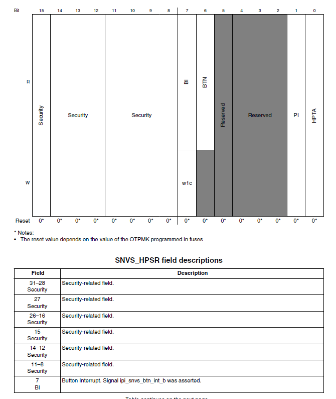

ajaybande
Hi Igor,
Thank you for Reply.
I have flashed OTPMK register, Still I am getting same events.
I have checked SNVS_HP Status Register, but I am not bale to interpret  is it correct or some thing is wrong?
SNVS_HP Status Register log:-
MX6QSABRELITE U-Boot > md.l 0x20CC014
020cc014: 80000b00 00000000 00000000 00000000    ................
020cc024: 00000000 00000000 00000000 00000000    ................
020cc034: 00000000 00000000 00000000 00000000    ................
020cc044: 00000000 00000000 00000008 00000000    ................
020cc054: 00000000 00000000 00000000 00000000    ................
020cc064: 00000000 00000000 00000000 00000000    ................

SNVS_HP Detail:-
Best Regards
