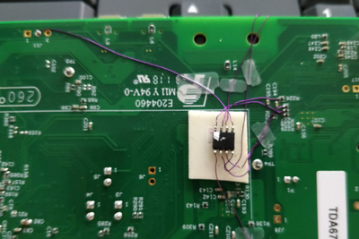

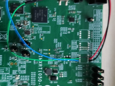

We are using evaluation board IMXRT1050-EVKB and trying to boot from the secondary FlexSPI pins:
GPIO_AD_B1_08
GPIO_AD_B1_09
GPIO_AD_B1_10
GPIO_AD_B1_11
GPIO_AD_B1_12
GPIO_AD_B1_13
GPIO_AD_B1_14
GPIO_AD_B1_15
We soldered a Flash to those pins:
Our board's configuration:
BOOT_MODE[1:0]= 10 (internal boot)
BOOT_CGG[10:8]= 111
Why does the internal boot still occur from Flash U33 (primary pins) and not from the secondary pins?
Should we do something else besides the HW setup I have mentioned?

Hi @sapirbuz ,
   As your connection is still the flexspi 1 A port, just the secondary pinout option for FlexSPI serial NOR flash boot.
  So the address still the same from 0X60000000.
Wish it helps you!
Kerry
