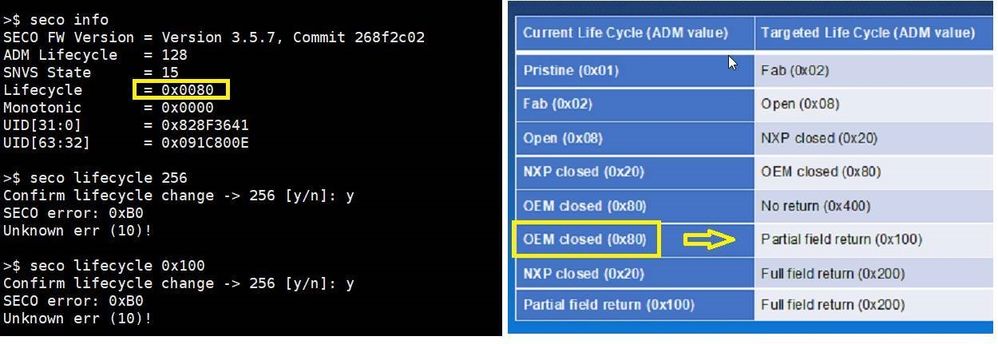

Dear Technical Support Engineer:
When I use i.MX8QXP, I find that after input seco info command by serial port, it prompt unkown cmd. How can I solve this problem ?
my CPU info as below:
CPU: Freescale i.MX8QXP revC A35 at 1200 MHz at 34C
Model: Freescale i.MX8DX MEK
Board: iMX8DX MEK
Boot: MMC0 DRAM: 994 MiB
gpio@5d090000: dir_output: error: gpio GPIO1_7 not reserved MMC: FSL_SDHC: 0, FSL_SDHC: 1
Loading Environment from MMC... *** Warning - bad CRC, using default environment
BuildInfo: -
SCFW b929edfe, SECO-FW 268f2c02, IMX-MKIMAGE d7f9440d, ATF bb209a0 - U-Boot 2018.03
I can use ahab_status to confirm lifecycle info,
and  i want change lifecycle data to "Partial field return"
but it prompt seco cmd unkown...
I call out the help. There is no seco instruction set in the help,
only ahab_ Close is a related instruction. so how can I change lifecycle to "Partial field return"?

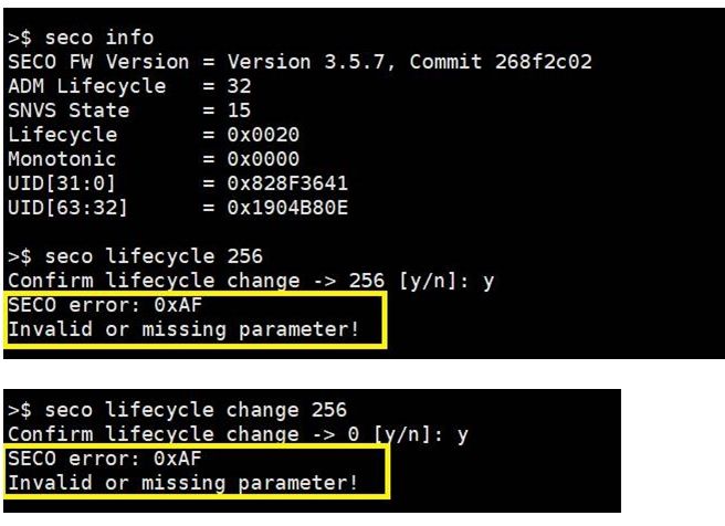

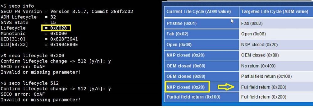

Hi :
I tried to use the other two machines to do the test, but both returned failures, and the error codes were different. Do you know the reason about that?
*SECO FW Version is 3.5.7,SCFW porting kit version is 1.3.1

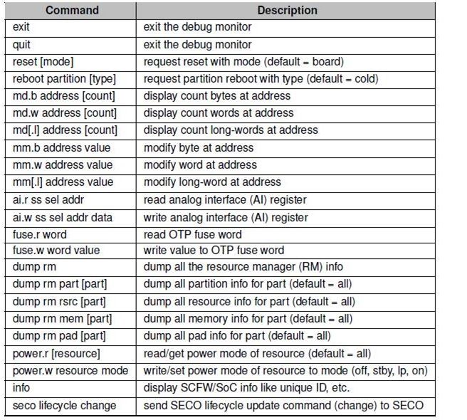

Dear Harvey:
I have confirmed the compilation configuration.
make qx B=mek R=B0 M=1  D=1,it looks right.
I have entered the serial port of SCFW (using the same serial port as M4).
But when I input the command as below, errorcode is returned. What is the reason about this?

nxf45220
You need a signed bootloader which got same HASH key as you fused in chips when you change lifecycle from 0x20 to 0x80.
