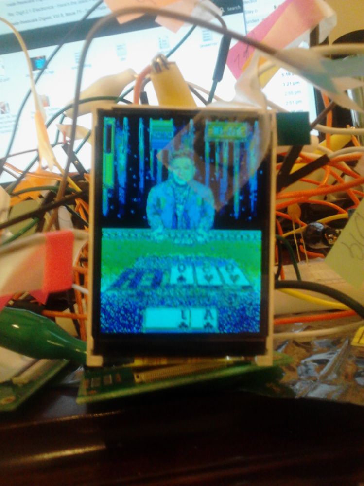

Attached is a pic and a video of a 2.4 inch lcd that I am trying to use in RGB 16 bit mode connected to a sabrelite imx6. The colors don't come out right. I have triple checked the pinouts. There is an abundance of blues. When I try to play video, it looks bluish and pixelated. The video attached is bugbuckbunny. Has anyone encountered this? I've tried using fbset to change the bpp to 18 and test it as well (making the corresponding changes to the lcd pinouts for 18-bit mode) but fbset does not seem to set the bpp. It is always hard-coded to 16. FYI, i've used a beaglbone to test that the lcd is not a defect, so the problem is real. any input is appreciated. Thankslcd.jpg

so I got this working. my pin mappings were wrong. they should be the following:
In 18 bit mode (note: kernel command line should be something on the order of video=mxcfb0:dev=lcd,800x480M@55,if=RGB666):
DISP0_DAT0:DISP0_DAT5 - B0-B5
DISP0_DAT6:DISP0_DAT11 - G0-G5
DISP0_DAT12:DISP0_DAT17 - R0-R5
In 16 bit mode:
DISP0_DAT0:DISP0_DAT4 - B0-B4
DISP0_DAT5:DISP0_DAT10 - G0-G5
DISP0_DAT11:DISP0_DAT15 - R0-R4
In the IMX6 reference manual, there is mention that this mapping can be changed in software (see sec 37.4.7.5.1 Bus Mapping Unit) but I haven't given this a try since I didn't need to.

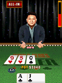

here is another clearer pic of the display on the lcd and the original image. Ignore the horizontal inverted image. This image on the lcd was displayed by writing to the fb directly: cat image.raw > /dev/fb0
