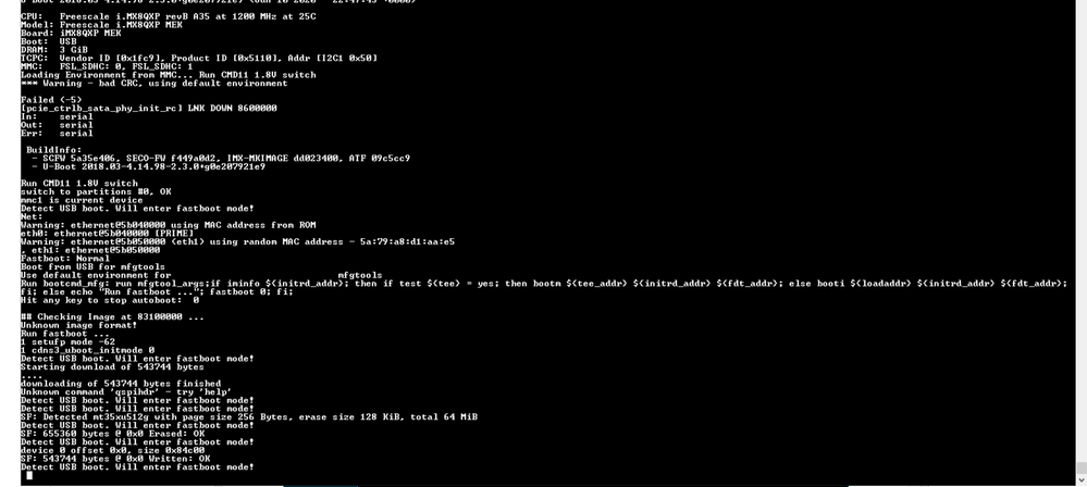

I need to run and debug modified iMX8QX SCFW and M4 SDK in a proprietary board, Getting Started with MCUXpresso
SDK for MEK-MIMX8QX document only contains instructions about making a bootable SD card but my board only supports serial download ( UUU ). How can Run M4 SDK using IAR to debug with UUU?

yes, but I also need to debug M4 code using IAR.

I created 2 bin files :
make SOC=iMX8QX R=B0 flash_cm4_xip
make SOC=iMX8QX R=B0 flash_flexspi
copied this to UUU folder and executed :
uuu -b qspi flash_uboot.bin flash.bin
I got the following :
Then changed the switches to boot from QSPI and cycled power on the board. but nothing happened.
I'm attaching the files I used.
I'm working on iMX8QXP-MEK

pls check the steps as below:
using make "SOC=iMX8QX flash_cm4_xip" or "make SOC=iMX8QX flash_linux_m4_xip" to generate the desired flash.bin.
   (The first one is to generate a flash.bin which only contains the M4 XIP image,
   the second one is to generate a flash.bin which contains both M4 XIP and U-Boot.)
after uuu -b qspi flash_uboot.bin flash.bin, power off the board, change the boot mode to QSPI[0110], and power on the board again.
   If using "make SOC=iMX8QX flash_cm4_xip" in step 3, one UART console will display M4 demo output.
  if using "make SOC=iMX8QX flash_linux_m4_xip", you will need mx8qm-ahab-container.img, scfw_tcm.bin, u-boot-spl.bin, u-boot.bin, m4_image.bin, b31.bin under imx-mkimage/iMX8QX.
