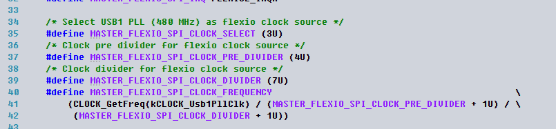

oneofzero
I am currently driving a ST7789 SPI LCD, with a resolution of 320X240X16bit. It takes about 30ms to refresh a screen with spi, so the SPI speed is only 40Mhz.
I modified the code according to the example of “boards\evkbimxrt1050\driver_examples\flexio\spi\edma_lpspi_transfer\master”
I changed MASTER_FLEXIO_SPI_CLOCK_PRE_DIVIDER to 1 MASTER_FLEXIO_SPI_CLOCK_DIVIDER also changed to 1
MASTER_FLEXIO_SPI_CLOCK_FREQUENCY is now 120X1000X1000hz
I also tried to make this MASTER_FLEXIO_SPI_CLOCK_FREQUENCY bigger, but it didn’t work.
The baudRate_Bps of flexio_spi_master_config_t can’t break through the speed of 40Mhz. No matter what value I change it to.

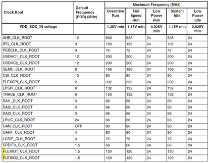

As mentioned in the i.MX RT1050 Processor Reference Manual. Chapter 49 Flexible I/O (FlexIO): the maximum baud rate value you could have for SPI Master is: MASTER_FLEXIO_SPI_CLOCK_FREQUENCY / 4.
[Section 49.4.3. SPI Master]
Nonetheless, the maximum MASTER_FLEXIO_SPI_CLOCK FREQUENCY that that the xRT1050 RM is 120MHz:
[Table 14-5. System Clock Frequency Values]
So, you might not be able to reach a higher baud rate/frequency value than 40MHz, since the guaranteed value is from 30MHz.
