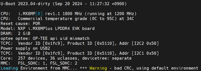

leotang
Dear Zhiming,
         I just changed the RAM SIZE and the lpddr4 timing for 2G in the u-boot.So which part shoud I check?Could you point me the specific part I should check ,as I have no idea how to check

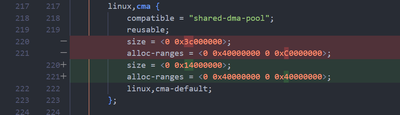

Zhiming_Liu
Need to modify kernel device tree with 2GB.
For example,
--- a/arch/arm64/boot/dts/freescale/imx8mp.dtsi
+++ b/arch/arm64/boot/dts/freescale/imx8mp.dtsi
@@ -186,8 +186,8 @@
                linux,cma {
                        compatible = "shared-dma-pool";
                        reusable;
-                       size = <0 0x3c000000>;
-                       alloc-ranges = <0 0x40000000 0 0xC0000000>;
+                       size = <0 0x14000000>;
+                       alloc-ranges = <0 0x40000000 0 0x40000000>;
                        linux,cma-default;
@@ -2315,7 +2315,7 @@
        mix_gpu_ml: mix_gpu_ml {
                compatible = "fsl,imx8mp-gpu", "fsl,imx8-gpu-ss";
                cores = <&gpu_3d>, <&ml_vipsi>, <&gpu_2d>;
-               reg = <0x0 0x40000000 0x0 0xC0000000>, <0x0 0x0 0x0 0x10000000>;
+               reg = <0x0 0x40000000 0x0 0x40000000>, <0x0 0x0 0x0 0x10000000>;
                reg-names = "phys_baseaddr", "contiguous_mem";
                status = "disabled";
Best Regards
Zhiming

leotang
Dear Zhiming,
          I have modified the device tree as your example.
But I have got the same result.
The attachment is the full bootlog for reference.

Zhiming_Liu
Can you share modifications about PHYS_SDRAM_2_SIZE and PHYS_SDRAM_SIZE ?

leotang
Below is my define for PHYS_SDRAM_SIZE
But I don't define PHYS_SDRAM_2_SIZE
#define CONFIG_SYS_SDRAM_BASE 0x40000000
#define PHYS_SDRAM 0x40000000
#define PHYS_SDRAM_SIZE 0x80000000 /* 2 GB */
#define PHYS_SDRAM_2 0x100000000

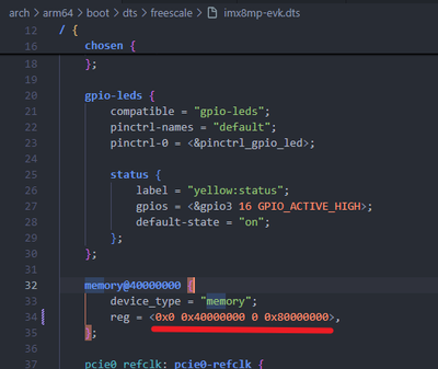

Zhiming_Liu
Hi @leotang
Please try to modify memory node in dts referring below screenshot.
Best Regards
Zhiming

leotang
Dear Zhiming,
I have modified the porting you suggest
But it seems the same result.I have added the full boot log in the attachment for your reference.
Thx

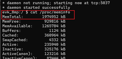

Hi @leotang
Current aosp on my side is Android14, in order to be able to quickly test, i use it to test.
Here is my test  on evk board, try to limint DDR size on software.

U-Boot SPL 2023.04-dirty (Sep 20 2024 - 11:27:32 +0900)
DDRINFO: start DRAM init
DDRINFO: DRAM rate 4000MTS
DDRINFO:ddrphy calibration done
DDRINFO: ddrmix config done
SEC0:  RNG instantiated
Normal Boot
Trying to boot from MMC2
NOTICE:  Do not release JR0 to NS as it can be used by HAB
NOTICE:  BL31: v2.8(release):automotive-14.0.0_1.1.0-0-g7d5458822
NOTICE:  BL31: Built : 11:27:52, Sep 20 2024
modifications:
Zhiming_Liu_3-1726817664578.pngZhiming_Liu_5-1726819194401.pngZhiming_Liu_6-1726819255803.png
There is no other place need to modify for 2GB DDR porting.
You can see that the system memory is 2GB and there is no crash on EVK board. Maybe you can try to re-calibrate and stress  test the ddr.
