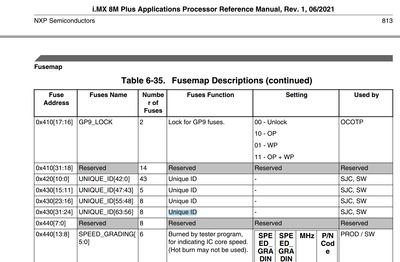

In the i.MX8M-Plus chip there is said to be (i.MX 8M Plus Applications Processor Reference Manual, Rev. 1, 06/2021 page 813) a "Unique ID" at the fuse address 0x410 that can be read out. However, it is unclear how to proceed here.

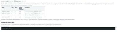

I could successfully read OCOTP_MAC_ADDR0 Mac address using (bank 9 word 0 and word 1) using the suggested command:
dd status=none if=/sys/bus/nvmem/devices/imx-ocotp0/nvmem of=/dev/stdout bs=4 count=1 skip=36 | hexdump -v -e '4/4 "%08x " "\n"'
dd status=none if=/sys/bus/nvmem/devices/imx-ocotp0/nvmem of=/dev/stdout bs=4 count=1 skip=37 | hexdump -v -e '4/4 "%08x " "\n"'
as suggested in
https://www.digi.com/resources/documentation/digidocs/embedded/dey/3.0/cc8mnano/bsp_r_otp_8m
I found the bank/word resolution here:
https://wiki.phytec.com/display/public/MD/L-1017e.A1+i.MX+8M+Plus+BSP+Manual#L1017e.A1i.MX8MPlusBSPM...
As for the Unique ID, the ref manual gives the address but not the corresponding bank/word but I guess this should not be too hard to find out.

What's interesting is the OCOTP_HW_OCOTP_TESTERx bytes lower address words match the Fusemap descriptions i.e.
Address: 3035_0000h base + 420h offset = 3035_0420h   OCOTP_HW_OCOTP_TESTER1 ->  UID 0x420
Address: 3035_0000h base + 430h offset = 3035_0430h  OCOTP_HW_OCOTP_TESTER2 ->   UID 0x430
Up until the iMX7D these are what Freescale advised us to use for the UID; and as the OCOTP_HW_OCOTP_TESTER bytes are termed 'shadow' registers in the iMX8 I wonder if they contain the same information? Worth asking NXP..
If you can find a suitable table within the MMR manual of where everything sits and since you know your MAC it might be worth see if there is a correlation..
